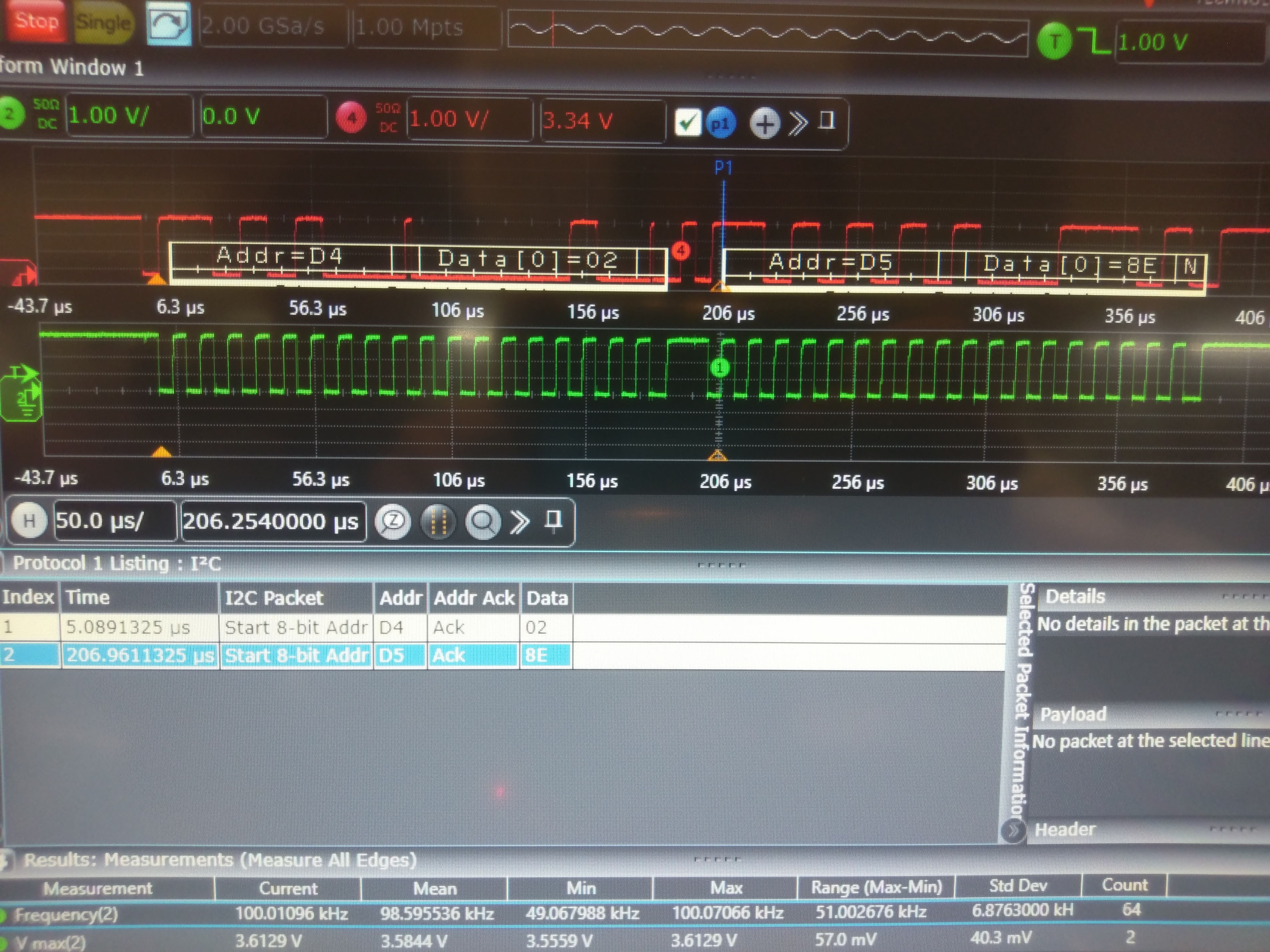

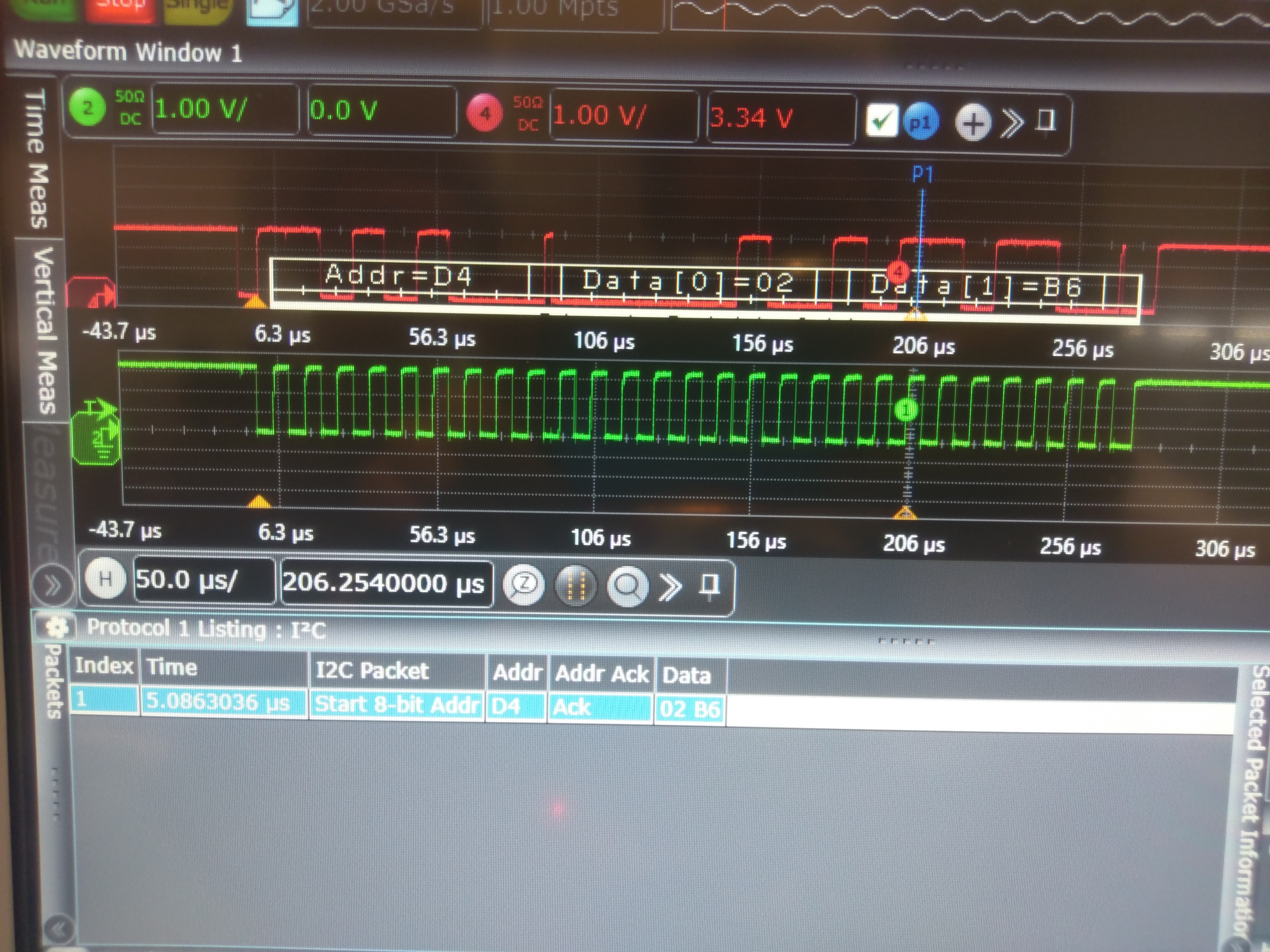

BQ24158YFFT I2C register write and read issue.
We found the write data and read data are not the same and below is my write/read process, register and data.
1. Write BQ24158 register 0x02, data 0xb6,
2. Read Bq24158 register 0x02, data is 0x8E
I attached the I2C write/read waveform for check, please help to review the I2C waveform, thanks.
Mark
  • Mark,
    Are you writing to the watchdog timer?  If the watchdog expires, the registers return to default values.
    Jeff
  • Hi Jeff,
    We trigger the watchdog timer every 25sec.
    Could you provide write and read I2C waveform of BQ24158 to me for double check the timing and sequence?
    Thanks.
    Mark
  • Hi Mark,
    This behavior is expected. Writing B6 to 0x02 sets VBATREG=4.40V.  If the safety limit register has maximum charge voltage set to 4.20V (default), the charger will automatically clamp VBATREG=4.20V (which is 8E).  If you want to set VBATREG = 4.40V, you have to first set the max battery voltage to 4.40V in register 6.  Register 6 must be the first register written after power up from either VBUS or BAT (CSOUT).  It resets to default if V(CSOUT) drops to ~2.1V.
