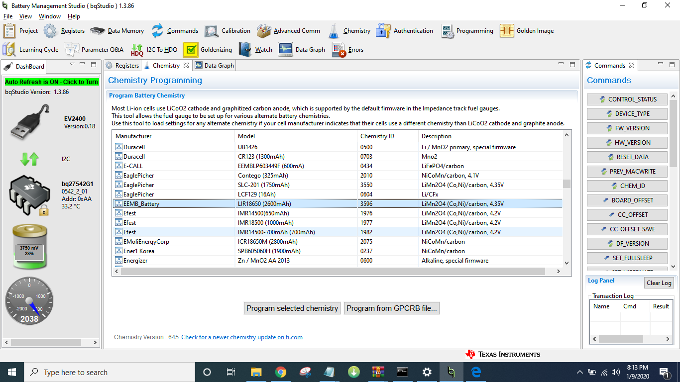

    We performed one test for generating chemical ID for our cell as per the steps recommended by the TI. Based on this test, the best Chemical ID which we received from the report was 3596. When we search in the list of Chemistry from Battery Management Studio we found the capacity to be 2600 mAh and nominal voltage of 4.35 V. But the capacity listed in its datasheet is 12000 mAh and nominal voltage of 3.7 V. Can you please help us on this ?
    I am attaching the log file for the test and the test report which we received from the TI. I am also attaching the screenshot from my Battery Management Studio
     for this.
    Mahek

  • That matching Chemical ID means that the OCV table and resistance table this is corresponding to that chem id matches your battery most.
    After your load the Chem ID,  the next thing to do is the learning cycle.  Before the learning cycle runs,  certain parameters need to be configured specifically to your application and your battery type in the gauge data flash. For example,  the design capacity and design voltage.
