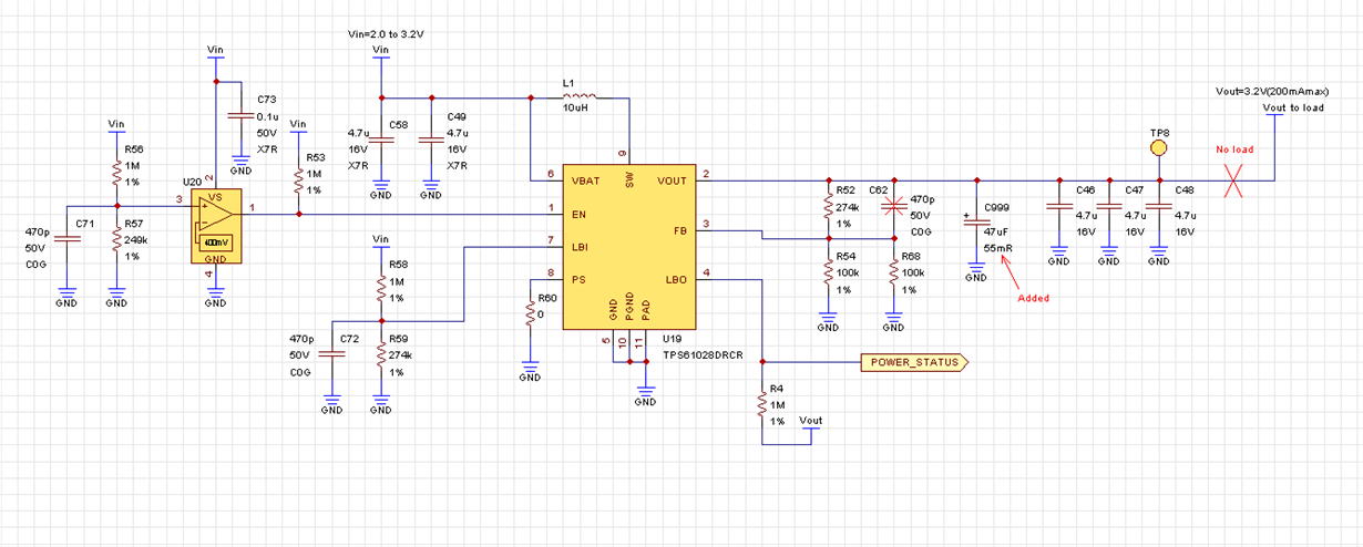

I designed using TPS61028.
However, with 2 of the 4 boards, Vout dropped after 30 minutes to one hour.
- Vin: 2~3.2V(Alkaline battery x 2)
- Vout:3.2V(In the program)
- Vout: 1.6V(After dropped voltage)
- Iout: 200mA(Max.)
- Cin: 4.7uF x 2
- Cout: 4.7uF x 3
- EN and LBI-LBO pins are working normally.
Find the schematic below.
Please advise how to solve.
Thank you in advance
Toru

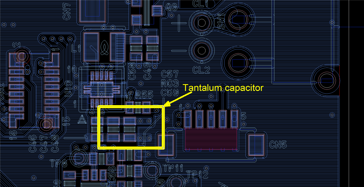

  • Hi Li-san,
    I read other threads and thought that the problem could be affected by the board layout.
    Please find the board layout below.
    1. L1
    2. L4
    3. L1 + L4
    Please check above board layouts.
    Toru
  • Hi Toru,
    the device operates at the beginning, but not after a period, so the IC should be damaged.
    there are some problem in the schematic,
    1. this device need a 47uF tantalum capacitor which has 50mR ESR.
    2. please remove the feed-forward 470pF C52.
    3. the EN pin is controlled by output of the comparator to set the UVLO from my understanding. please add hysteresis to the comparator to avoid high frequency on/off at the EN pin. i would suggest less than 10Hz
    the layout is not most optimized, but I think it is not highest risk leading to the damage. so let's try to change the external components firstly.

  • Hi Li-san,
    I mounted and tested it with a 47uF tantalum capacitor.
     1. Replaced TPS61028.
     2. Removed 470pF C62.
     3. Removed C46 to C48 and mounted a 47uF tantalum capacitor with 55mOhm ESR.
    But the output voltage was 1.6V, the same as before.
    So I removed the load you asked me before and measured the output voltage.
    The output voltage was 9.2V.
    Please find  waveforms below.
    Do you think this IC is broken?
    Please give me some advice.
    Toru
  • Hi Toru,
    please don't remove the C46~C48, just add the tantalum capacitor.  the output voltage is not regulated. it seem like the FB pin or the R52, R54 are not well soldered.
    1. place the C46 and C48 back, add the tantalum capacitor.
    2. remove the C62.
    3. replace the IC
    4. don't add load at the beginning.
    do the same process in several boards. make sure the components are well soldered before power up.
    the hysteresis is small, i would suggest enlarge this value. make sure there is oscillation in the output of the comparator.

  • Hi Toru,
    the FB is high impedance, so the FB pin voltage depends on the feedback divider. several reasons lead to zero voltage at FB pin
    1.. FB is short to GND, which could be checked by multimeter.
    2. the R52 is open,
    the device reply on the FB pin voltage to control the output voltage. so please make sure the FB pin circuit is correct.
  • Hi Li-san,
    Thank you for your advices.
    I checked the FB pin circuit again.
    And I found that R52 was not connected to Vout.
    I measured Vout and FB pin voltage.
    Vout =3.3V
    FB pin = 507mV
    Please find the  current circuit below.
    Do you think this result is correct?
    Toru
