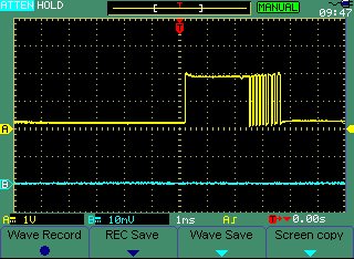

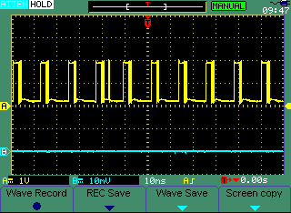

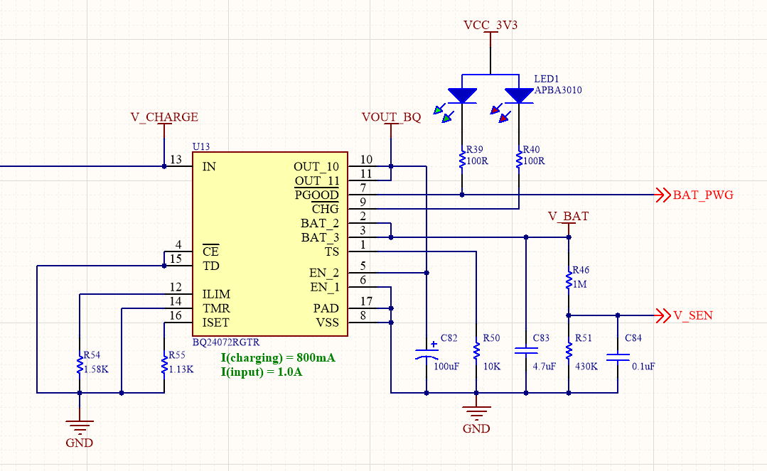

I use the next scheme for BQ24072:
If I connecting input viltage(USB_5V) - BAT_PWG(PGOOD) must pull down.
But not in my cases. I have pulsation on this output
Why?
I hope for an your reply.
