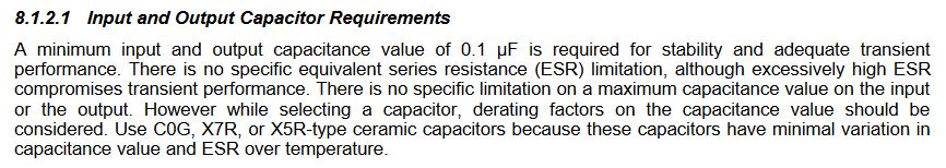

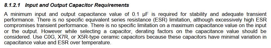

Dear Sirs,
Is there some extra data regarding the limits of ESR for the output capacitance? (ESR versus Co)
VS
  • Hi VS,
    Per the datasheet, there are no restrictions on the ESR.
    As ESR increases, the capacitors ability to provide a surge of current during load transient events will diminish.
    Please consider the transient response you need on the output when choosing an output capacitor.
    - Stephen

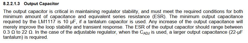

  • Hi VS,
    Here are the answers:
    TLV1117
    ESR requirement is between 0.2 ohms and 10 ohms.
    LM1117
    ESR requirement is between 0.3 ohms to 22 ohms.
    LM1086
    Unfortunately, the datasheet does not provide a specific value but states that "tantalum" and "aluminum electrolytic" capacitors will stabilize the LDO.  The ESR of these capacitor types are on par with the LM1117 and TLV1117.
