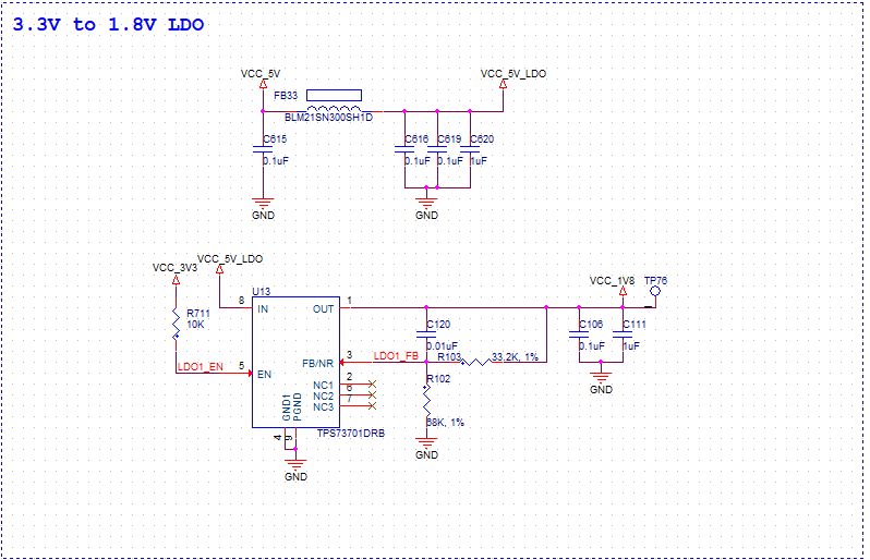

I am attaching the schematics of TPS73701DRB part used in my desgin, please review it and let me know your feeback.
Hi Team,

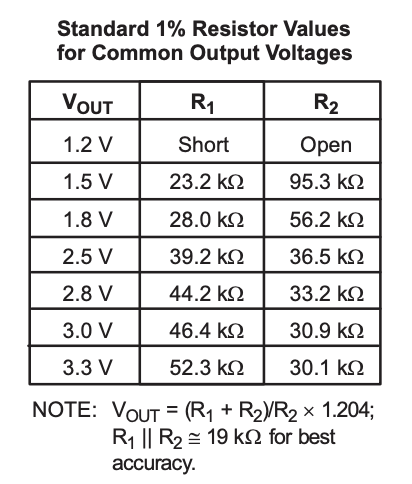

Thanks for the update, I changed the resistors accordingly.
The input is 5V not 3.3V, apologise for the typing mistake.
