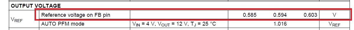

I understand that like the following.
I'd like to set 7.9V.
In the case of Forced PWM,
Vout = 0.594 * (1 + 1230k/100k) = 7.9V.
By the way,
If I will also use Auto PFM mode, could you please tell me the value of Vref?
Vout = 1.016 * (1 + 1230k/100k) = 13.5V?
