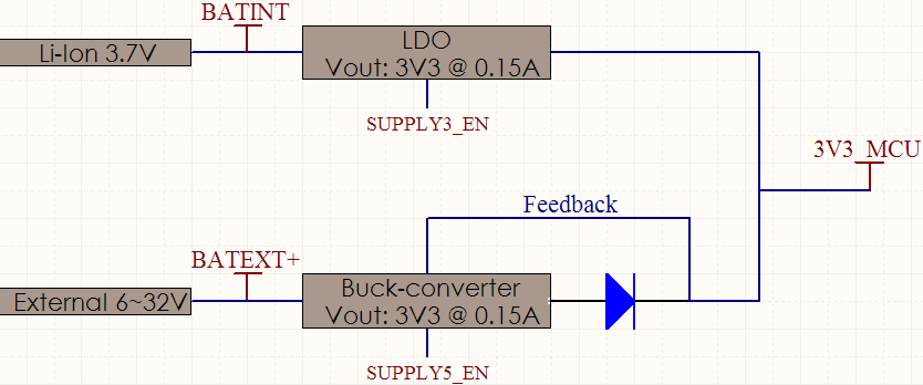

  • When you say the IC is turned off, you mean the inputs and outputs go to a HiZ state? In that state, is there any isolation between the IC pins and the external environment? And between the input and the output?
    What happens if I connect another power source in the LDO output when it's in the disabled state (i.e., if I have two power sources connected together)?

    Unfortunately there is no industry understanding for what "Off" means. And in fact due to the physics of the mosfet there is no way to prevent backward, or reverse, current through the body diode of the main pass FET in the case where there is an output voltage higher than the input voltage - even during shut down.  During shutdown you can consider the Vin pin to be Hi-Z, and the FB pin is Hi-Z by definition.  But again the Vout pin is problematic and voltage on this can possibly cause uncharacterized current flow.

    Considering what you said, I'll probably have problems with the design I'm considering now, with two power sources for the same power line (as in the image below):
    The buck converter would be constantly powered by the external power supply. When that external supply goes OFF, the LDO is turnned ON.
    The diode in the output of the buck converter is meant to eliminate problems with the LDO power going into the buck IC, but for the LDO I can't use that, as I need a low drop out (considering my battery voltage and my system voltage). Do you suggest something so that I don't have current flowing inside the LDO when it's disabled?

    We run into this alot. Using an additional diode at the LDO increases loss and or forces you to run the mcu at a lower voltage. But unfortunately it is the best I can suggest.
