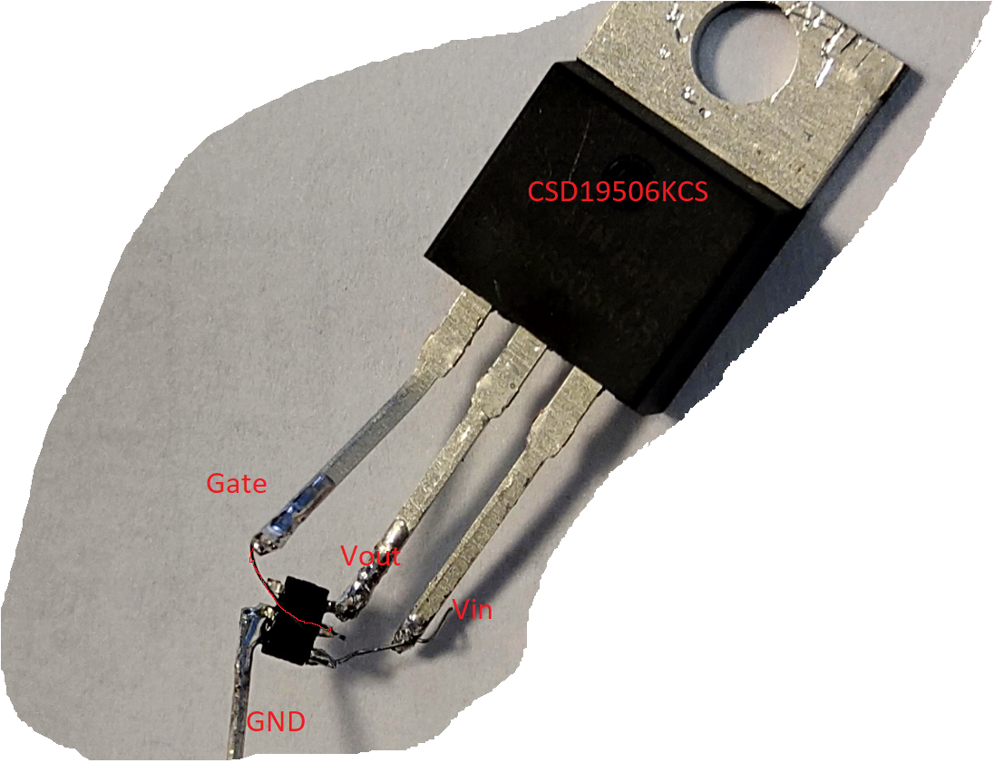

How can prevent deactivate gate command for prevent to broke diode.
1. Can add some filters to prevent deactivation of FET for prevent broke internal diode?
2.To prevent broke LM5050 don't need to command GATE of FET via resistor?

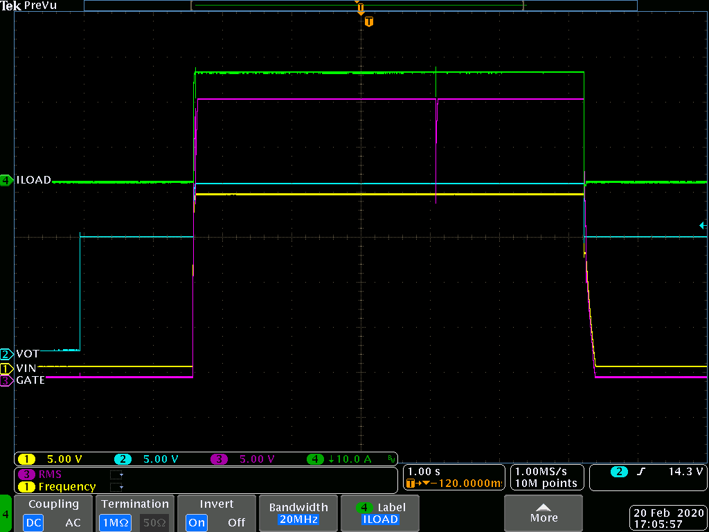

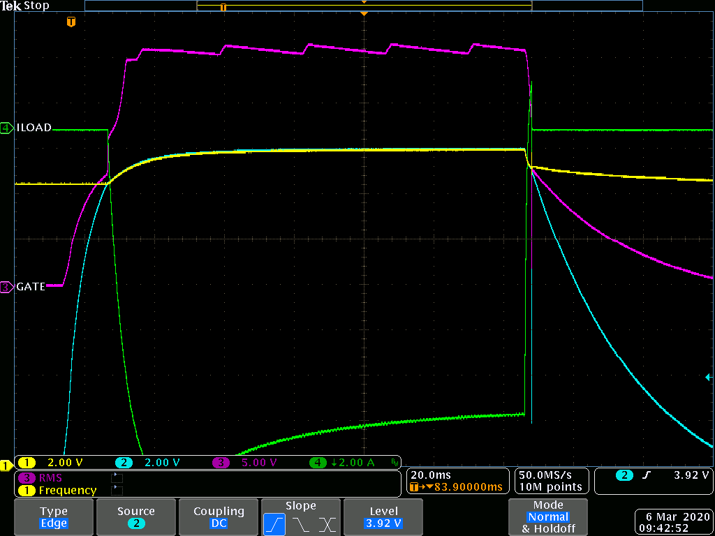

In the waveform we see the IN coming after OUT.

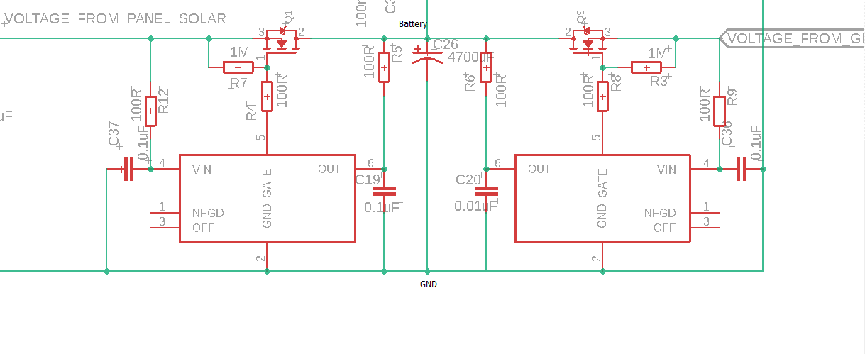

To understand better and aid in root cause, can you share the schematic.

The latest schematic is look like this:
