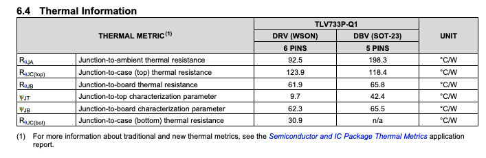

My customer want to know the following about thermal information.
1.Do you have the items in this table [RθJA, RθJC(top), RθJB, ψJT, ψJB, RθJC(bot)] shown in the image diagram ?
2.What is the difference between RθJB and RθJC (bot) ?
3.The ΨJT of DRV is considerably smaller than the ΨJT of DBV.
   Is there no problem ? Why small ?

  • HI Hayashi-san,
    For question number 1: The image did not get posted but this is our standard thermal table:
    For question #2: RθJB is the Junction to Board thermal resistance. RθJC (bot) is the Junction-to-case (power pad) thermal resistance
    For Question #3: The ΨJT if the DRV is smaller as the amount of mold compound between the die and the top is much less than the DBV package.
    I hope this answers your questions.

    1.Sorry, I forgot to update.
       Here is the table.
       Do you have a diagram of this table ?

  • Hi JCHK-san
    It is an additional question about 3.
    Is the ΨJT small because only the DRV TOP is thinner than the DBV ?

  • HI Hayashi-san,
    I think you are asking for a detailed description of these parameters. If so, here you go:
    θJA -  This is the Junction-to-ambient thermal resistance
    θJC(bot) - This is the junction-to-case (power pad) thermal resistance
    θJC(top) - The junction-to-case (top of the case) thermal resistance
             Note: if you are going to measure this temp using an IR thermal camera you must use the right
                     settings for the emissivity of the surface and very small spot size to get an accurate measurement.
    θJB - The junction-to-board thermal resistance. Note: this is from the junction to the pins
    ψJT - The junction-to-top-of-package characterization parameter
    ψJB - The junction-to-board characterization parameter
    Practically, useful terms are θJA and ψJT.  θJA is used to predict the thermal rise above PCB ambient. While once you have the board, ψJT can be used to confirm the actual junction temperature in the application.
    TJ=TA+(θJA*PD) where TJ is the predicted Junction Temperature, TA is the PCB ambient temperature, and PD is the power dissipated (VIN-VOUT)*ILOAD
    and for ψJT:
    TJ=PD*ψJT+ TMEASURED where TMEASURED is the temperature measurement at the top of the package.
    To answer your question on ψJT and the DRV yes, there is physically less material between the die and the top of the case. Looking at the above equation for ψJT the less material or thermal resistance between the die and the top of the package, the closer your measure is to the actual die temperature.
    Does this help to clarify your questions?
