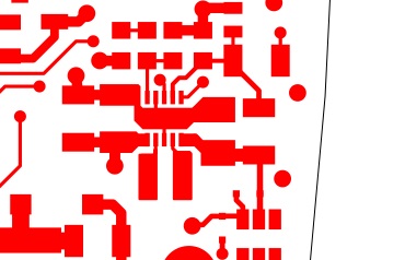

  • Hi Mike,
    You can upload images by clicking the "Insert/Edit Media" button when replying.
    This behavior is not normal. Two possible causes are:
    1. Non-optimal PCB layout. Could you please post the PCB layout? Just a snippet of the area around the device, showing all layers, is enough.
    2. Failed part. Could you please replace the device and test the circuit again?

    Here is the schematic
    Here is the PCB section
    Mike

  • Hi Mike,
    I tried to reproduce the issue on the bench, but as I expected, everything worked normal, regardless of which mode the device operates in.
    Your layout looks fine. Normally, we recommend VINA to be decoupled to GND via 100 nF, as it is done on the EVM:
    http://www.ti.com/lit/ug/slvu275/slvu275.pdf
    Did you try to replace the device and see if the issue still exists?
    If it is still there, could you please take scope plots during startup, to show the Vin rise, showing signals on VIN, VOUT, PS/SYNC and L1 pins.

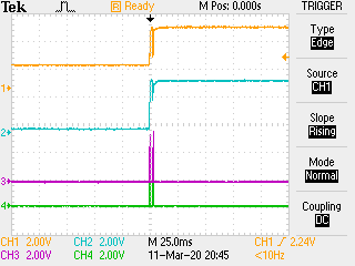

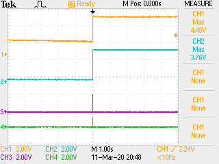

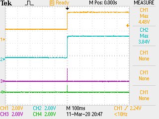

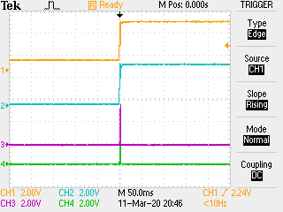

    The images below are the requested captures at three levels of VBAT (which connects to VIN via a diode).
    CH1 = VIN
    CH2 = VOUT
    CH3 = L1
    CH4 = PS/SYNC
    VBAT at 4.5V.
    VBAT at 4.0V.
    VBAT at 3.5V
    Should we have activity on L1 when in the step down mode?
    Mike
  • Hi Mike,
    I configured the device the same way you did (VINA to VIN, PS to GND via R/C, EN to VBAT), except for the inductor (1.5 uH, but that shouldn't affect the behavior). I am using a 20V/1A schottky diode (B120/B-13). I did not see any problems, regardless of the power mode (PS pin state), input/output voltages or output current.
    There is always activity on both L1 and L2 pins in power-save mode. In power-save mode, the device operates in bursts. During the bursts one pin goes high and the other actively switches, or both actively switch, depending on input/output voltages.
    If VIN goes to 10 V, the device should fail, or stop when there is a voltage breakdown. In any case, if VIN goes to 10 V, that means that both input diodes should be off since Vbat and Vusb are <10 V. In that case the power can only come from somewhere else.
    1. Can you please show a scope plot for VIN, VOUT, L1 and L2 over a longer time, from startup until VIN reaches 10 V?
    2. Do you have any load on the output? From the scope plots I see that initially the output voltage rises to the nominal value, but after that there is a dip, as if something is turned on on the output?
    3. Do you have a board without this issue? If so, can you try A-B-A swap.

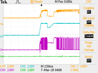

    For some reason (I do not know why) we are not seeing 10V on VIN now.  However the output does not regulate when VIN is at 4.5V.  Here are some scope captures at difference durations.
    CH1 = VIN
    CH2 = VOUT
    CH3 = L1
    CH4 = L2
    We ordered the TPS63030 evaluation board, some new TPS63030 chips and some 1.5uH inductors.
    I will let you know if we get the same or better results.
    It looks like out TPS63030 might be damaged since there is no activity on either L1 or L2 when stepping down the voltage.
    Mike
  • Hi Mike,
    Looking at the latest scope plots, I see two possibilities. Either the device is damaged and does not work for higher input voltages, or there is something on the output providing path to a voltage higher than 3.3 V. For example, if there is a pull-up path from VOUT to VBAT somewhere on the output/load, this would pull VOUT up and prevent the device from switching, so no activity on L1/L2. In power-save mode (PS pin connected to GND) this is expected behavior, and does not mean that the device is damaged.
    Double check with an evaluation module will help. In the meantime:
    1. In your previous tests (scope plots), do you have anything connected to the output of the converter?
    2. Can you check VOUT with PS/SYNC connected to VIN (therefore putting the device into forced-PWM mode) and apply 4.5 V to input?
    Milos
    1. The rest of our circuit is connected to the out put of the TPS63030.
    2. In the captures above PS/SYNC is connected to VIN before and after 4.5V is applied.
    I will test with VOUT not connected to the rest of the circuit and let you know what I find.
    Mike
    You were right, I was wrong. There was a diode in backwards that was feeding VBATT to VDD.
    We are all good now.
    Thank you for helping us through this.
    Mike
