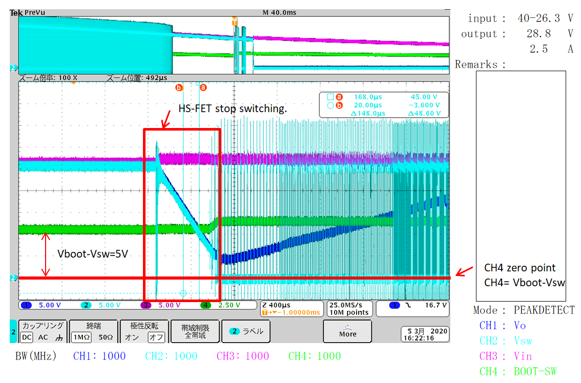

I can't read out BOOT-SW voltage ,is CH4= Vboot-Vsw or only Vboot, where of its zero point?
TPS54560B work at 100% need thereis sufficicent votlage between Boot and SW . for you case, I suspect that the voltage between boot and SW drop down to Boot UVLO which made the high side fet turned off.

Our situation is below :
(1)The BOOT to SW pin voltage is 5V and greater than 2.1V at SW abnormal point.
(2)The Vin pin voltage is 25V.
Why does the small low-side MOSFET work in our situation?
We think the small low-side MOSFET does not work at SW abnormal point.

At abnomal point:
(Vin=25V) > (Internal UVLO= 4.48Vmax)
※We confirmed that Vin is greater than 25V.
We think UVLO does not work at SW abnormal point.

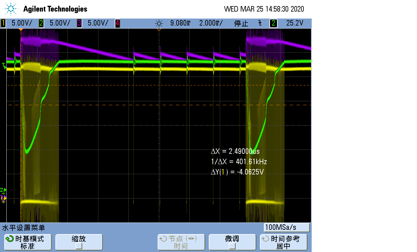

is it possible to share the inductor current waveform? whether there is some kind of load transient at high side abnormal point?

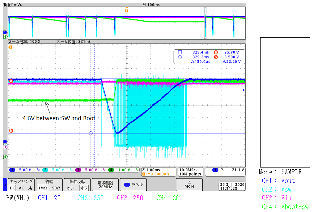

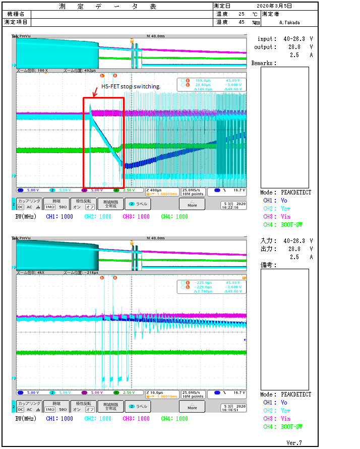

We have been able to recreate the problem with the modified TPS54560EVM-515 for 28.8V.
The output current is 3A, and when we reduce the input voltage from 40V, this problem was recreate around 25.8V.
The circuit daiagram and waveform with problem are shown below.
This behavior is not written on the data sheet.
There are TPS54560B that has this problem and does not.
We think that this is your fault on design.
Anyway, this is serious broblem for us, so we strongly request you to resolve this problem as soon as possible.

Hi
I am verify the EVM based on below modification. when the Vin at 27V, the internal pull down mosfet will switch its working statues which make the Vo drop no matter at 2A or 0A.
CH1=SW, CH2=Vo, CH3=Boot
And when we add a constant 4V between SW and Boot, it will solve the issue. so the issue is made by internal boot recharge circuit active and de-active at Vin=27V and VO dropout condition.
and you can find some way for improve the boot circuit by below apps notes.
Hi
based on my EVM , it has issue at 27Vin. and can you see no any pulse at low Vin condition? I add a 4V, so SW and Boot voltage will be around 3.5V.
from you waveform, it looks you keep the input voltage at 27V, is that right? can you share your email address?we can discuss through email
