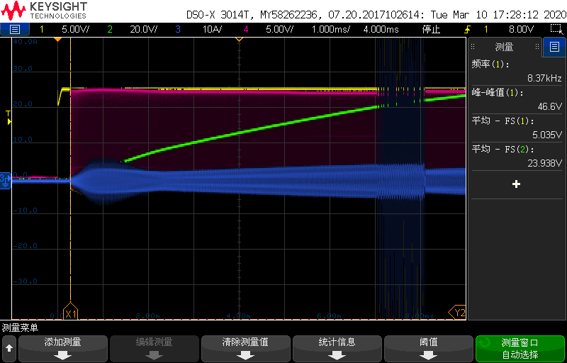

About UCC256402, I have several questions listed below:
1.How to set the startup frequency? The startup sometimes works OK and sometimes the current may become very large and trig ocp.  Figure 1 is the normal startup waveform and figure 2 is the abnormal one. They are test under the same conditon.
CH1: low_drive   CH4:up_drive     CH3:current_Cr
2.If one MOS of the half bridge LLC has been broken due to some reason, does UCC256402 have any protection to prevent the other MOS from shoot through?
figure1
figure2
  • During power on the frequency is controlled by soft start - you can change soft start capacitor CSS to adjust soft start time.

  • For the first question, my understanding is that the startup current can be reduced by adjusting the soft start time?

  • Thanks. But the startup problem is still not fixed. I have tried to set the initial voltage to 0.3V or even disable the ss initial function to rise up the startup efficiency. Sometimes the soft start is ok, but sometimes the soft start failed under the same Vin and load condition.
  • If you see inconsistent behavior, usually something not made properly. Which needs to track down such as solder connections, not good connections, etc., these are not something can be supported through E2E. You have to track your circuit by probe, such as sensing, VDD, etc, to find out.
    I suggest you get an EVM so you can have a reference point to compare your waveform to the EVM waveform.
