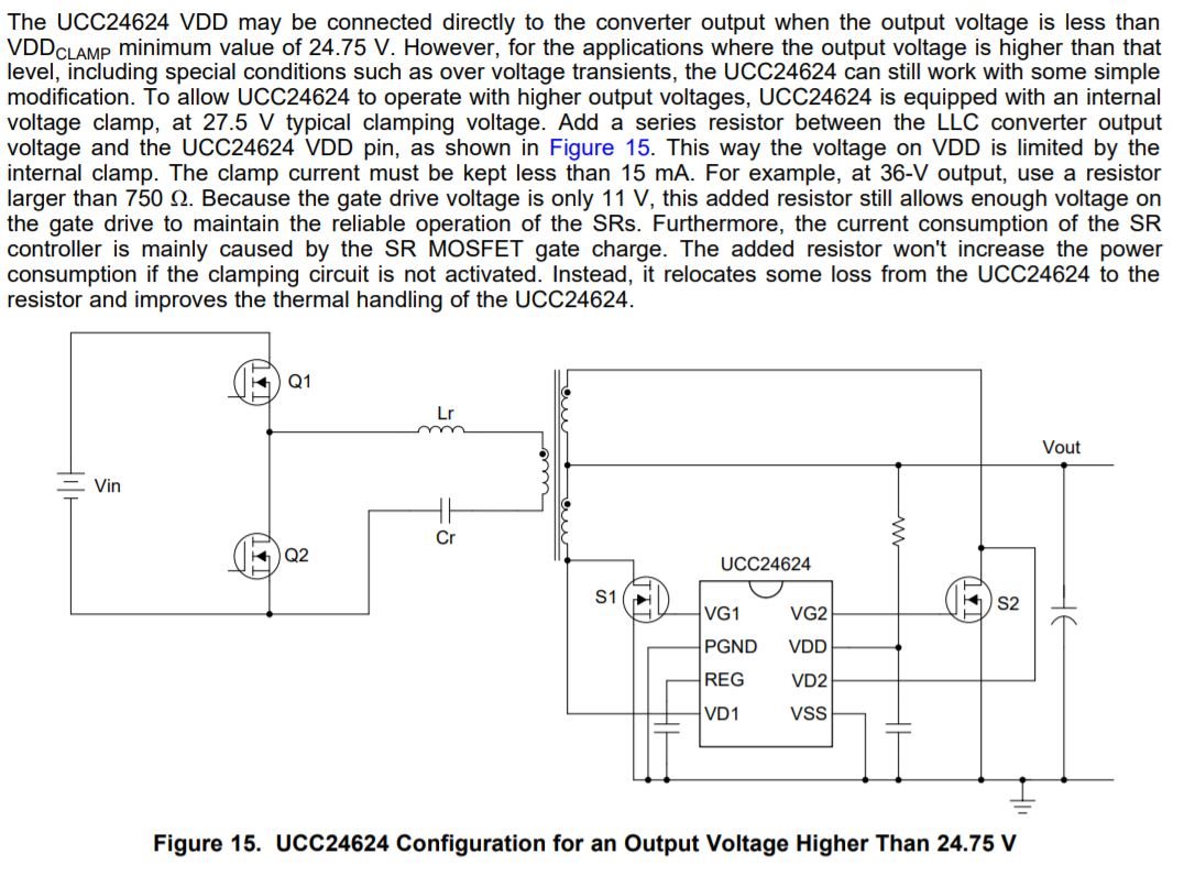

VDD_CLAMP is specified between min 24.75V and max 29.5V at IVDD = 15 mA but VVDD is specified MAX 26V as recommended operating conditions and 28V as absolute maximum ratings.
How should we think on this ?
Customer should use up to 26V for VVDD ?

  • The recommended is between 4.5V and 26V when internal clamping is not triggered or triggered but with the current <= 15mA. If you have voltage that can trigger clamping with current > 15mA, you need to add current limit resistor.

  • The recommended table should be followed. If the external bias can be > 26V, then a current limit resistor should be added along with your expectation how high the VDD can reach.
  • Hi Hong,
    Could you kindly advise how to determine the appropriate value for current limit resister ?
    How could customer follow the datasheet if supply voltage was more than recommendation such as figure 15 ?
    Michiaki
  • The recommended operation table suggests you design within the table specified range. Figure 15 suggests if VDD is higher than the recommended range listed in the table. If the VDD in your design <= 26V, add a current limit resistor is not a must. when you need to add a resistor, the resistor value can be determined in the way of recommendation along with Figure 15 to setup VDD = 24.75V, or you can calculate the resistor value with VDD = 26V. The device can work either way. But the power losses will be different. The Figure 15 gives design with some margin to reduce power losses.

  • The minimum clamping is 24.75V, with this minimum clamping, if applying 26V on to VDD without external current limit resistor, the IC is still ok. But you cannot assume every IC has clamping voltage 29.5V, and you have to think about the worst case as 24.75V. That is why you need to add current limit resistor when VDD > 26V since the IC can have clamping between 24.75 and 29.5V and you do not know which one has 24.75 and which one has 29.5V so you need treat for the worst case. But if you know the VDD not > 26V, it is your option to add or not to add the current limit resistor, either way, the IC will be safe to operate but may show different power losses.

  • If you know VDD maximum is 26V, and typical is 24V, no need to add the current limit resistor.
    If your output voltage = 24V, the internal Zener does not conduct, the current will be < 15mA, no matter the Zener clamping voltage is 24.75V or 29.5V.
    If your output voltage = 26V, and the internal Zener clamping between 26V and 29.5V, the internal Zener does not conduct, the current < 15mA.
    If your output voltage = 26V, and the internal Zener clamping is 24.75V, then the current is 15mA from internal Zener characteristics.
    So no need to add the resistor if your max VDD is 26V.
    If your VDD max is > 26V, please provide the max VDD, I can provide the resistor value for you.
  • Hi
    Max VDD will be 30.69V.
    Please provide the recommended resistor value.

  • Resistor value 332-ohm can be used.
