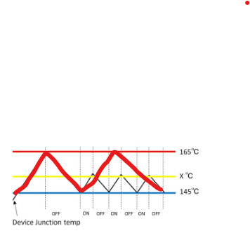

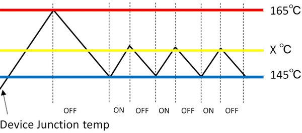

Part Number: TLV702
Could you tell me about TLV702 thermal shutdown operation?
1.TLV702 thermal shutdown operation as follows.
Is this understanding right?
2.Please tell me the temperature of X part.

Hi Yusuke,
The thermal shutdown of the TLV702 only has two states. When the junction temperature exceeds 165C, the device is shutting down itself and when the junction of the device is dropping below 145C, the part is re-enabling itself. z
The junction temperature of the device could stay at a temperature between 165 and 145C.
