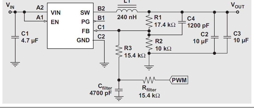

What is the output voltage range which you want to adjust? And what is the output voltage when you add the load? what is the value it drops to?
Shawn
The input voltage is 24V, and this converter can't support 100% duty cycle, 24V output voltage is impossible.
If you adjust the output voltage to 5V or 12V, and then add the load, does it still has this issue?
Shawn
The schematic looks fine. Please share the layout, let's review it.
And you can try to remove the MCU signal, keep the default output, and then check if there still have the same issue.
Shawn
Hi Youssef,
Since you have confirmed the device works well after removed the MCU signal, could you please try with a mirror change to the RC filter at the FB pin?
