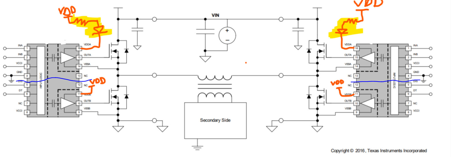

Hello team, I want to design an h bridge inverter, I do not have much knowledge to drive mosfets, can i drive 4 opto-coupler with one isolated power supply?
or 4 isolated power supply for each opto-coupler.
And i need a suggestion opto-coupler that can work in 100kHz.

    Yes, you can use a single isolated power supply for your devices. However, for the high-side drivers, you'll want to use a bootstrap circuit which, as the name suggest, bootstraps the high-side VGS using a diode and capacitor to bias the highside FET (shown in the figure below).
    Firstly, you asked about optocoupler-based gate driver recommendation. We have a line of opto-compatible gate drivers (UCC23xxx series) which are drop-in replacements for optocouplers and have key advantages (lower delay, longevity, superior part-part timing matching).  these are designed to be drop-in replacements for legacy designs that already used optocouplers.
    Our opto-compatible drivers are only single output as well, so you would require 4 seperate gate drivers for your full-bridge.
    One of our dual-channel isolated gate driversare great options if you're not restricted on using opto gate driver.
    The difference in the implementation is shown in the figure below. With our opto-emulated parts, you split those dual output drivers down the blue line and you have to have 4 gate drivers vs 2. This figure also shows how the full H bridge is implemented with boostrap circuit to only use a single power supply.
    If you're not restricted to using opto isolated gate driver, let me know and I can make other recommendations that might end up simplifying your design. But since you specifically asked about opto, i'll go ahead with the details on those parts.

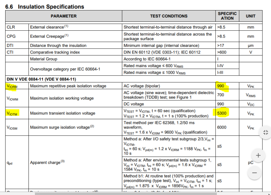

    Depending on the design & the voltages you're working with, you'll either want to choose between basic & reinforced isolation options for our opto-compatible drivers and drive current. Thankfully, the ratings can help you make a quick decision on which one you need better. And all of these handle 100kHz without issue.
    Unless the voltage you are working with
    Basic Isolation:
    UCC23313 - 4A / 5A, 3.75kVrms
    Reinforced Isolation:
    UCC23511 - , 1.5A / 2A, 5.7kVrms
    UCC23513 - 4A / 5A, 5.7kVrms
    Section 6.6 of their datasheets shows the isolation parameters that determine the selection of basic/reinforced based on your voltage, example below.
    VIORM is the maximum voltage the parts can are rated to handle repetitively.
    Without knowing the information on your design, I can't say for sure. But unless you expect to see voltages approaching the 900V and need isolation >5kV, UCC23313 is the better option.

  • Wow , thank you for you great answer sır!
    i will work on it. Thank again for you detailed answer thank you thank you!
    I also want to supply a secondary referenced pwm integrated with a flyback converter at an average of 15V.
    I will use this pwm controller to drive 4 mosfets.
    If I use boostrap, can I feed my optos on this line? wich is fed by a flyback converter.

    You can use an isolated flyback to supply 15V to UCC23X1X like you mentioned, as this is above the 14V minimum output-side supply specified in the datasheet, and then this can be used with a bootstrap circuit to generate highside bias. Note that the voltage should be maintained above this limit.
    The bootstrap circuit should work well for your application. The case where bootstrap would not work is when the highside FET needs to remain switched for arbitrary length of time, which is not the case for your application.
