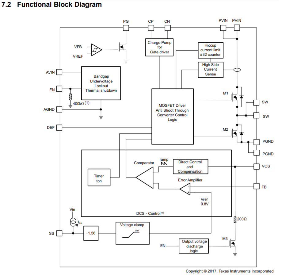

Is there internal capacitance between FB and VOS?
If so, would you tell me that capacity?

    I am not sure if there is any physical capacitor connected between the two pins. Any valuable information that is not confidential can be found in the datasheet. Based on the block diagram below, I do not see any capacitor connected between the pins.

    An abnormal output problem has occurred due to the mismatch between the internal capacitance and the external resistance with other company's power IC.
    Other company's IC has internal capacitance by design.
    So we wanted to know that.
