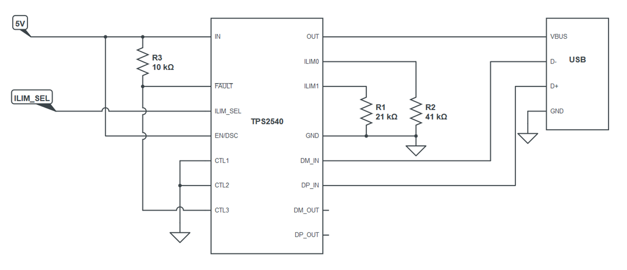

    What if I use a TPS2540 and use the FAULT pin to trigger an OUT discharge? Let me explain:
    I connect CTL1 and CTL2 to ground and CTL3 to FAULT (which is pulled up to HIGH). ILIM_SEL is controlled by a different circuit that can set it to HIGH or LOW depending on the current that we want to supply (2A or 1A).
    When ILIM_SEL is HIGH the TPS2540 advertises 2A and the CLT pins are 001 (Dedicated charging port, auto-detect) since FAULT is not asserted. The connected device pulls 2A and is working as usual.
    When ILIM_SEL changes to LOW, the connected device is not aware of this new current limit so it continues pulling 2A. However the TP2540 is indeed aware of the new current limit and FAULT is then asserted pulling CTL3 to LOW. This makes the CTL pins change to 000 (OUT discharge, power switch OFF). This way it forces an OUT discharge.
    When FAULT is not asserted anymore CTL3 returns to HIGH and the CTL pins revert to 001 (Dedicated charging port, auto-detect). Then a power negotiation is done with the correct current limit (1A).
    Would this work?
    From my understanding, this would only work with transitions of ILIM_SEL from high current to low current. It would not work for transitions of ILIM_SEL from low current to high current. But that is fine with me.
  • I forgot to add the schematic:
    No I would not suggest using this implementation. If there is a fault event, VBUS will automatically discharge, there is no need to connect the fault pin to the CTL pin to force a discharge
    Also, this method will have no effect on the connected device because there is no way for it to know what the current limit of the TPS2540 is. This value is not advertised or  shared. Only the TPS2540 will know what the current limit is. Also, the current limit updates immediately after the value at ILIM_SEL changes. There is no need to discharge VBUS to go to the new current setting

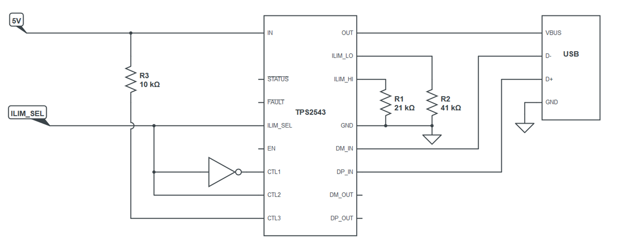

  • Hi Adam,
    So what if I use TPS2543 which supports 2/2.7V and 2.7/2V divider modes. I checked with Apple's spec and these divider modes happen to match nearly perfectly with what I needed:
    Divider mode
    D+ D- R1 R2 R3 R4 Max current
    Divider 1 2.0V 2.7V 75kΩ 49.9kΩ 43.2kΩ 49.9kΩ 1.0A
    Divider 2 2.7V 2.0V 43.2kΩ 49.9kΩ 75kΩ 49.9kΩ 2.1A
    I would make the connections as in my schematic (see below) so that I can toggle between these two states:
    CTL1 CTL2 CTL3 ILIM_SEL MODE CURRENT LIMIT SETTING
    0 1 1 1 DCP_Auto ILIM_HI
    1 0 1 0 DCP/Divider 1 ILIM_LO
    In DCP_Auto mode the TPS2543 will automatically switch between BC1.2 (1.5A), Divider 1 (1.0A), and Divider 2 (2.1A) mode, allowing a maximum current of 2.1A.
    In DCP/Divider 1 mode the TPS2543 is forced to stay in Divider 1 mode which will advertise a 1.0A max current.
    I understand that the TPS2543 will force an OUT discharge to trigger a power renegotiation when changing between these states.
    Will this work?
    David
  • Yes, this should work
