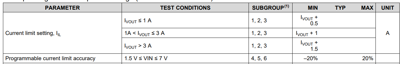

Hello.
I have a question about TPS7H2201-SP.
Is it possible to set the current limit on 100 mA, to watch the nominal output current in range of 80 mA?
