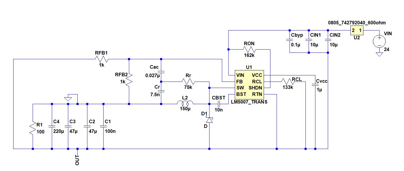

My aim is to convert +24V to -5V by using the LM5007 as an inverting buck-boost converter.
To ensure that my circuit works, I simulated it in LTspice.
For the LM5007 I used TI's officially provided PSpice Model.

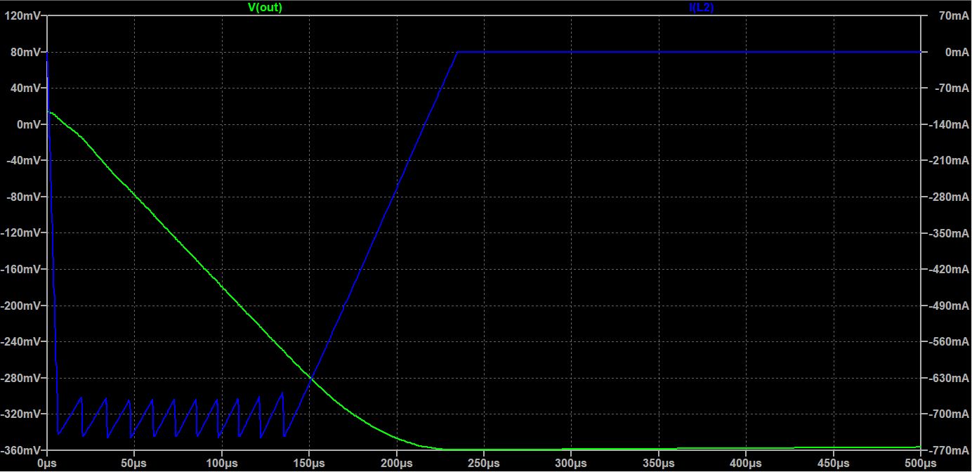

As shown below, I don't get an output voltage of -5V. Does it have something to do with the overcurrent protection (compare I(L2)) or is it possible that the PSpice-Model of the LM5007 cannot be used for inverting topologies?

    Unfortunately, the spice model on the web does not support the inverting topology.
    Some of our devices have models that support the inverting topology; that will be stated in the model file name.
    However, the LM5007 can be used in the inverting topology.  I have attached an app note that may be helpful with
    your design.  Also, the best way to validate your design is to get an EVM for this device and test in the lab.  The
    ordinary EVM can be used to test as an inverting buck-boost, as stated in the app note.
