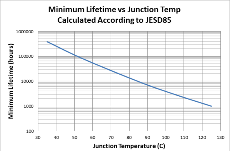

    So their max junction temp should be between 99C-124C, keeping them within the specification. The last thing to consider is how often the LDOs are going to be running at these extended temperatures (this would be a combination of how often the 1.2A at Vin=13.2V is being applied and how often the ambient temp is at the max of 45C). Catalog IC's are qualified using the JEDEC standards JESD22-A108 and JESD85 which ensures IC's can operate at Tj=55C for approximately 9 years but the lifetime decreases as the temperature increases (which is often overlooked). Just to give you a sense of the effect junction temp has on IC lifetime below is a graph showing the minimum lifetime vs junction temp based on the JEDEC standards.

    Sorry about that, some how I made a silly error and miscalculated the power dissipation, you are right it should be 3.6W which takes it ~1 degree beyond the rated junction temperature  (126C) even with the best PCB layout case. So if they really optimize the board for thermals they'll be right at or above the max junction temperature which wouldn't really result in much of a difference from a performance point of view however it makes the comments I made previously on minimum lifetime even more relevant.
    So they'll need to do the analysis themselves to determine how they'd like to proceed however I'd suggest going with the three parallel LDOs. This topology would burn 1.2W of power dissipation per LDO and if we assume the PCB is only as good as the JEDEC board then we'd expect a max junction temp of ~83C so there is a significant amount of margin with this design.
