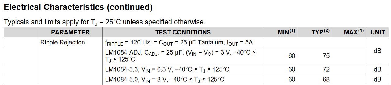

i have one question for LM1084ISX-3.3/NOPB
if Vin=12V, Vin(ripple)=150mVpp , vout =3.3V ,Iload=5A, What will be the vout ripple?

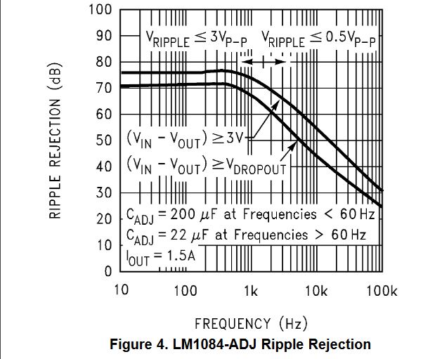

Hi Jericho,
The PSRR plot in the datasheet provides a good estimate on the attenuation you should expect in your application.
Once you exceed 3V of headroom (Vin-Vout), the PSRR plot is relatively insensitive to variations in Vin.
You will need to know the frequency of the ripple to determine your expected attenuation.
- Stephen
