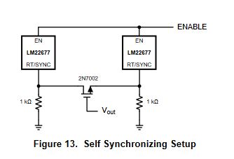

In the datasheet for LM22677 it details how two IC's can be connected together in self-synchronization mode. Is it possible to self-synchronize three of these IC's? If so, how would it be done?
