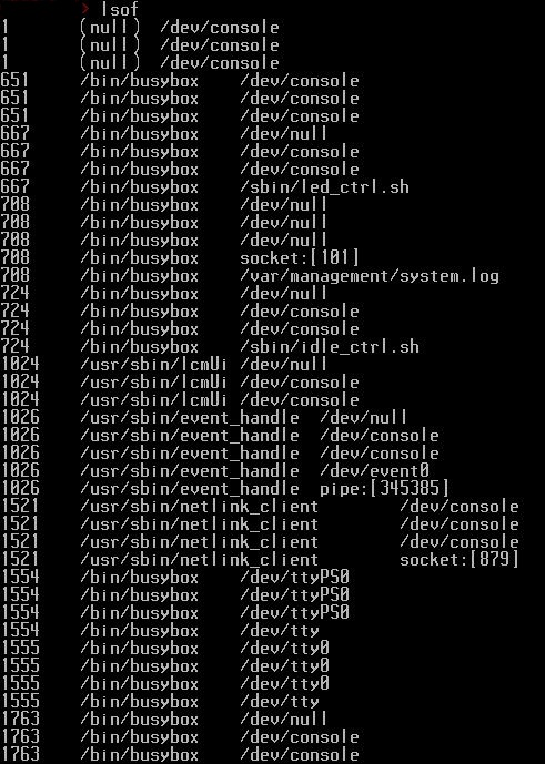

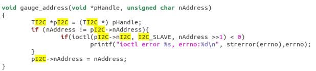

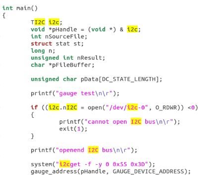

  • I execute the C code of "Gauge Communication", and it occurs "ioctl error Device or resource busy, errno:16" in gauge_address().
    I use "lsof" command to check who uses /dev/i2c-0 , but no body uses it.
    I try to execute system("i2cget -f -y 0 0x55 0x3D"), it is working well.
    How do I solve the problem "ioctl error Device or resource busy, errno:16", thanks?

  • Hi Nicorn,
    Unfortunately,  what you mentioned is more like a software issue than a device issue.  I'm not an expert on your host and therefore not able to tell you what might be wrong.
    What I can tell you is that the code mentioned int the app note has been used by lots of customers and hence the code itself is all good.  You may want to try some simple i2c read or write operations on your host and see if all of them can succeed.
