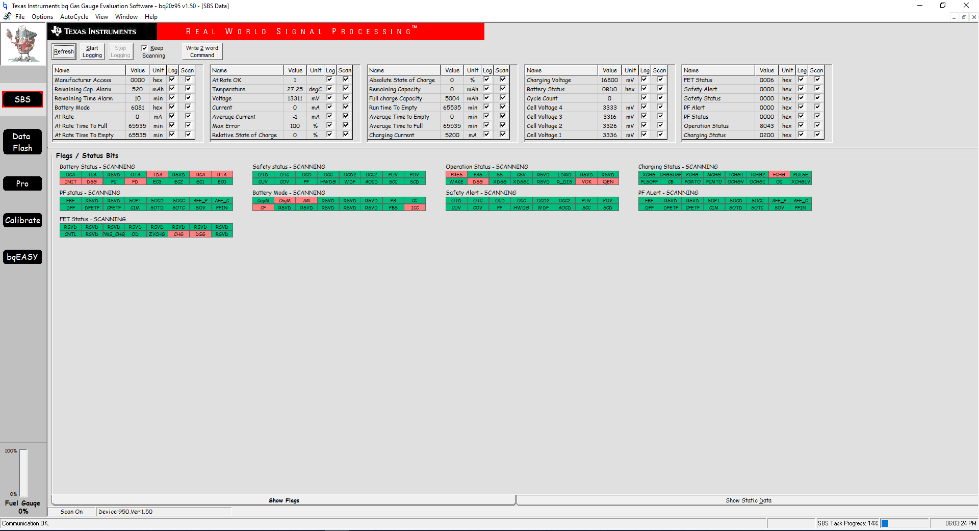

BQ20Z95: No discharge/charge current
Part Number: BQ20Z95
I'm trying to generate a golden image file to a battery pack with bq20z95.
I did the process with bqEASY.
Setup, Configure, Calibrate and Chemistry with no cells attached.
After the Chemistry part, I attached the cells and I'm trying to start the Learning Cycles part and there is no charge/discharge current.
I'm trying to discharge the battery with load and there is no discharge current and when I'm trying to charge the battery there is no charge current and the battery doesn't charge.
This is the Battery Status at this moment.
