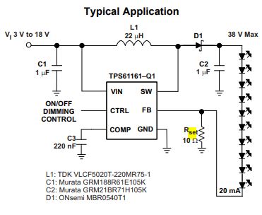

Hi Sirs,
My customer is asking a question which needs product line's suggestion:
According to the equation in datasheet, VFB = Duty * 200mV,
VFB is linear with four LEDs in series, LED current = 20mA with Rset = 20ohm or 10ohm.
However, VFB becomes non-leaner when Rst was reduced to 6.8ohm or 4.7ohm:
DUTY=100%, VFB=200 mV
DUTY=50%, VFB=160 mV
DUTY=20%, VFB=80 mV
Hence we would like to know the range of Rset to fit the equation of VFB = Duty * 200mV.

  • Hi Wayne,
        Please check whether the circuit is stable or not when you have decreased the RFB since it will deliver a higher output current when you decrease the RFB.

  • Hi Wayne,
         You'd better measure the voltage waveform of the "FB" pin and the current through the inductor to check whether the loop is stable or not.
         There is no special spec for the RFB range and stability.

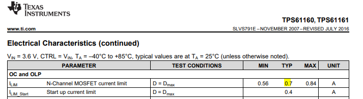

  • Hello Sean,
    Thank you for your advise. With customer's 5V power supply, four WLEDs in series, the output voltage of the boost converter is 3.4V*4+0.2V=13.8V.
    With 10ohm RSET, LED current = 0.2/10 = 20mA, output power is 13.8*20mA=0.276W. Consider the efficiency of the TPS61161 device, the inductor current >= 0.276W/5.0V = 0.0552A.
    With 6.2ohm RSET, LED current = 0.2/6.2 = 30mA,  output power is 13.8*30mA=0.414W. Consider the efficiency of the TPS61161 device, the inductor current >= 0.414W/5.0V = 0.0828A which can exceed 0.7A current limit specification of the TPS61161, hence 6.8ohm RSET is within specification in this case.
    Would you pls advise if my assumption correct?

  • Hi Wayne,
        Yes, but the current you calculate for the inductor is the average current, you also need to consider the current ripple of the inductor. Ipeak_inductor=Iavg+Iripple/2.

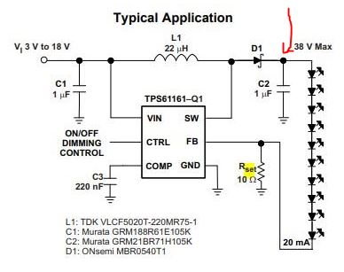

  • Hello Sean.
    Thank you for your confirmation, My customer got 20mA LED current with 10ohm and 6.8ohm of RSET, We assume that we should get higher output current with 6.8ohm RSET. We found the VFB was reducing with RSET, hence we would like to know the minimum requirement of the RSET.
    Would you pls advise if there is any missing or mistake with the configurations? The VF is 2.7V, we got 11.15V stable Vout in both conditions.

  • HI Wayne,
         It is strange that the VFB will decrease, can you measure the waveform of the "SW" or inductor current? You need to check whether the circuit is stable or not.
    BR
