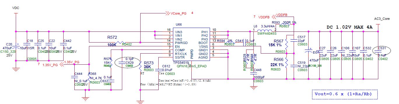

Hi team:
Can the capacitance value of C629 in the circuit be changed to 10PF?
Hello User,
Did you try to calculate this value using equation 21 of the datasheet?
You would need the ESR value the output capacitor value you are using here.
pF is the range of value you would expect this capacitor to have.
Thanks a lot!
Dorian

Hi,Dorian,
Thanks a lot ! I will try to Change 0.1pf capacitance to 10PF capacitance,And then look at the test results.
