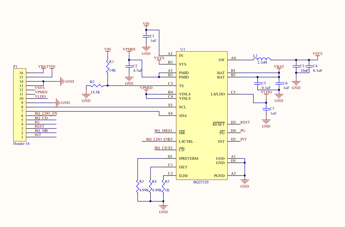

Hi Team,
In the process of using bq25120a as the battery charging management, we encountered two problems: 1. The battery power measurement was not accurate; 2. Sometimes it was displayed for a long time, but it could not be fully charged.
Would you pls help me check the sch?
