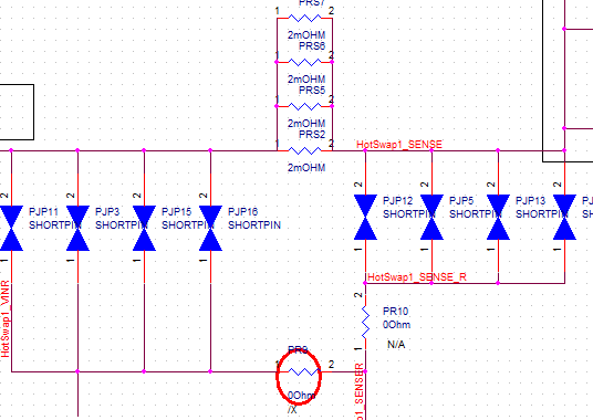

Below is a part of  circuit. Because of Power dissipation ,we parallel 4 Rsense in application.

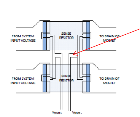

And layout will be as below (yellow lines are sense wire+- for R sense)
Because the limit in space.
1.Can all the sense+ wire connect together and sense- wire connect together too,and do not effect to hotswap's current sense and current limit?
2.Or can I put more RCL1 ,RCL2 ( in circuit is PR9,10) ,a pair per short pin for  convenience in layout?
