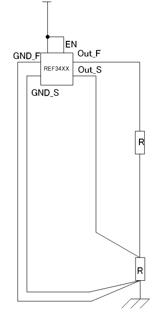

    Excuse me, but I have one more question.
    As shown in the attached figure,
    I would like to connect a resistor of the order of kilo Ω used in the pressure sensor bridge circuit between Out_S and Out_F.
    Is this all right?
    Taroimo
  • Hi Taroimo,
    The REF34xx will try to make the voltage at OUT_S = VREF. The REF34 might be able to support close to 0.5V upwards on OUT_F to adjust for the drop across the top "R" with a maximum of 10mA.
    What is the purpose of this circuit?

  • In my opinion it looks like the customer wants to create a precision current sink with one device to bias a sensor. This cannot be supported if it violates ABS Max or RoC.
    OUT_S is a sense input and OUT_F is the output voltage of the REF34. The ABS max output voltage of the REF34 is 5.5V, so if the 5V variant is used, only a max of 0.5V can be used for adjustment. So the maximum voltage drop across "R" can only be 0.5V for the 5V variant.
    The force/sense is meant to be used for smaller IR drops across traces. For lower voltages I recommend to keep a similar requirement in mind. For lower voltage variants, 0.7V can be acceptable.

  • The force and sense output is connected to the output buffer in a combination like the one below. The Op Amp will buffer the output to make sure the positive and negative voltages are the same. The OUT_S terminal will be regulated to equal the bandgap voltage. This is why OUT_S has to be the bandgap voltage.
    OUT_F will always be larger than OUT_S. The limit to how large OUT_F can be while still maintaining some regulation is limited and I gave it in the previous post. Keep in mind that if OUT_F is significantly larger than OUT_S the regulation will be impacted.

  • Hi Taroimo,
    The ABS max is an error and it will be fixed in the next revision that is coming up.
    The 5.5V ABS max is a limit with the internal designs and I cannot go into more detail into it.
    Keep in mind that the specifications on the EC table for the REF34 assume the OUT_F and OUT_S are shorted together. Any large deviations on OUT_F can deviate the specifications from the EC table since the OUT_F deviation is mean to be in the mV as per section 10.2.2.2.
