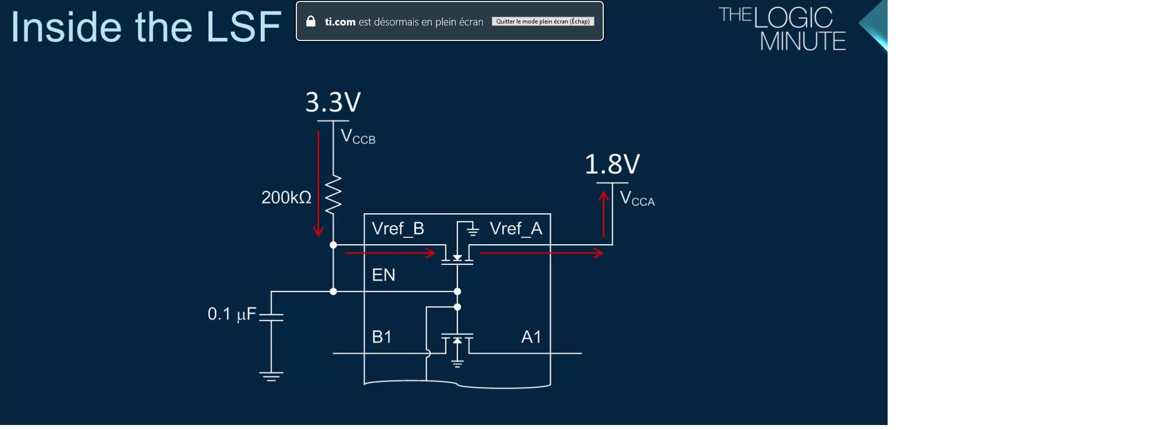

Dear TI,
For one of our application we intend to use the  LSF01 level shifters to convert an SDIo from 3V3 to 1V8. I saw in the logic minute that this device familly has a particular biasing circuit which requires the low level power supply (1V8) to be able to sink from the high level power supply (3V3), as you can see in the image below. Now, our design is using the LP87564 to generate the 1V8 on the board. I was therefor wondering if the LP87564 was able to sink the required  current for the targetted purpose? Can you help on this topic? Thanks in advance :-)
