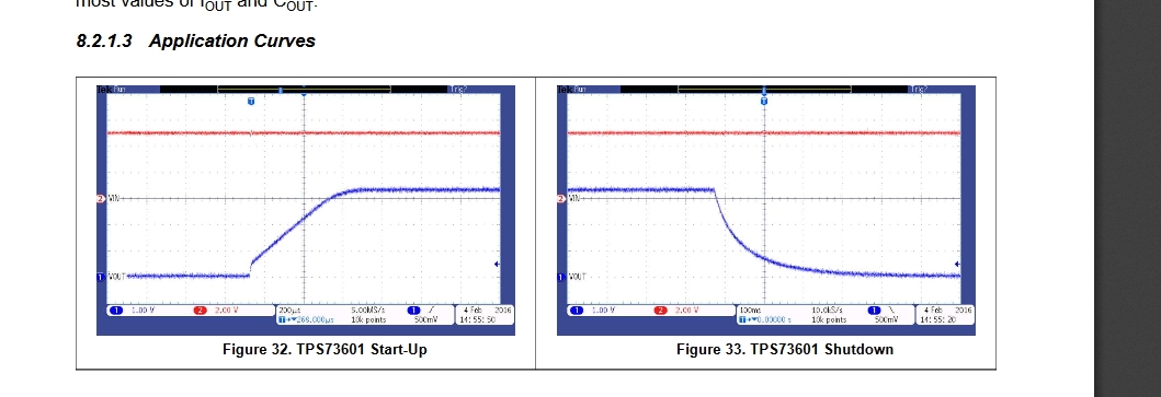

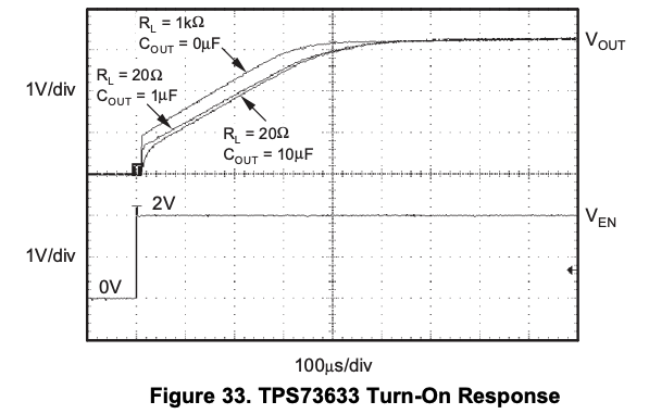

TPS736-Q1 use adjustable Output,TPS73601QDBVRQ1,it -supply  the COMS SENSOR,  Input 3.3V,output 1.8V&2.8VApplications is ADAS camera .
now,output 2.8V cannot be started,when COMS SENSOR is under strong light conditions,>2000 lumen,  but,1.8V can be started.
when Light <2000 lumen(COMS sensor),2.8V can be started.
But,Change TPS73601QDBVRQ1 to TLV73328PQDBVRQ1(Fixed Outputs),Light >2000 lumen(COMS sensor),2.8V can be started,
What could be the reason,
