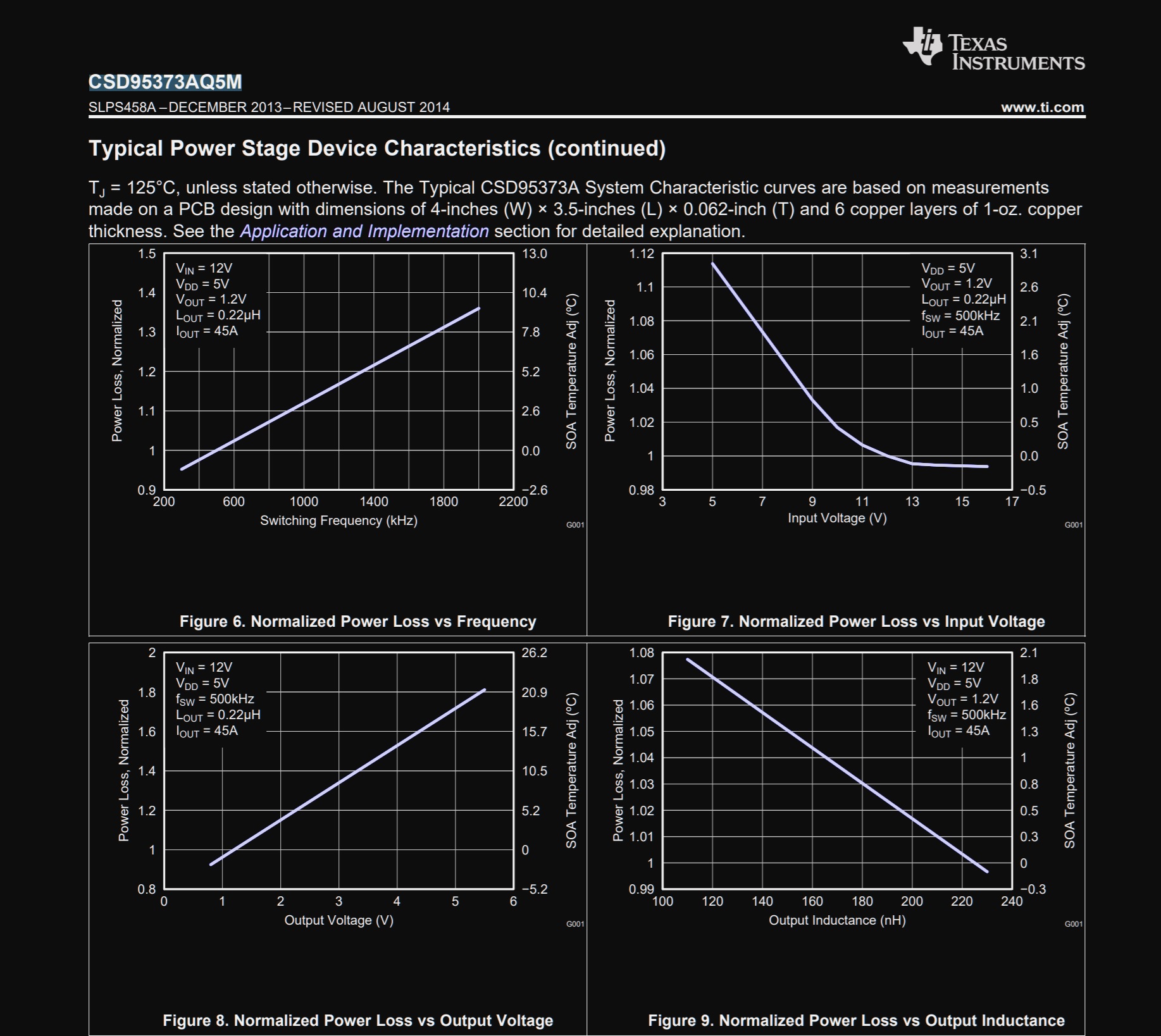

Looking at the data sheet for this power stage I am left wondering how the power loss of the part varies at voltages approaching the power supply rail as this data is not shown (see the screen shot below).
If I run the PWM input at 100% duty cycle and a load of only a few ohm will the losses therefore be large extrapolating the graph?  Why would that be given the bridge switches are fully on for the control and fully off for the sync FET (or vice versa).
Thanks!

  • Hi Qingquan, yes that's what I mean.  If I have logic high to the PWM input for several seconds for example and during that time the duty cycle is 100% will the losses therefore be high?  It seems odd given that switching losses are not occuring during this period.

  • Hi Chris,
    This is not a typical application for our power stage product, and that's why you don't see it in datasheet. In most of our applications, Vout is much lower than Vin (D<0.5).
    Due to the fact that our power stages are optimized for applications where duty is small (less than 0.5), the low side FET is  designed to be larger than the high side FET, hence less conduction losses if more current flow through the low side FET.
    Theoretically if you have 100% duty the power loss might be less as no switching losses in this case, but  you may have some technical issue to implement, as the high side FET driver receives power from bootstrap cap. The bootsrap cap will be drained with long logic high PWM pulse.
    Then if you have large duty cycle but not 100% (such as 95%), I would expect the power loss to increase with Vout, as we still have switching losses plus more conduction losses from HS FET.
    Please let me know if this answers your question.

  • Thanks Qingquan.  Theoretically I could also provide ~5V (VDD) + 12V (VIN) to the BOOT PIN via a boost circuit and that would allow for function at 100% duty cycle?  I thinking of including a small boost circuit on board as an optional source which can be connected to BOOT as the full board is expensive to make and additional BOOT voltage source as a fall back options might be a good idea?  Thats my last question :).
    Thanks, Chris.
  • Hi Chris,
    You could use an isolated 5V power supply to power BOOT pin, boost circuit may not work.
    The reason is we need 5V between BOOT and BOOTR pins, while BOOTR pin voltage is floating, and changing with VSW. So the power supply for BOOT pin needs to be able to float output negative terminal together with BOOTR pin. For boost circuit, the output is reference to GND.
    Qingquan

    OK thank you. I can't think of an immediate solution to providing 5V to BOOT relative to BOOTR using an external circuit.  This would probably be necessary as I will likely need 100% duty cycle at times.  Perhaps I can use a P-MOS N-MOS configured half bridge in place of CSD95373AQ5M instead?
  • Hi Chris,
    Actually you could find a lot of small isolated DCDC modules from some online distributors,  250mW should be enough to drive the boostrap circuit.
    Or if you want to drive with P-N MOS half bridge, you will need to use gate voltage same as your rail voltage (VIN, 0V), and make sure your MOS gate can be drove with such voltage.
    Another option is to use full bridge (two power stages) to drive, and control the phase between two half bridges, you could use 50% duty for each half bridge in this case.
