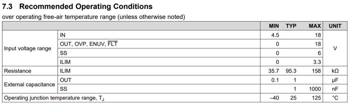

Please let me confirm the abs max of EN without VIN.
If VIN is zero voltage and EN is inputted something voltage, are there any concern or possible to go break down ?
