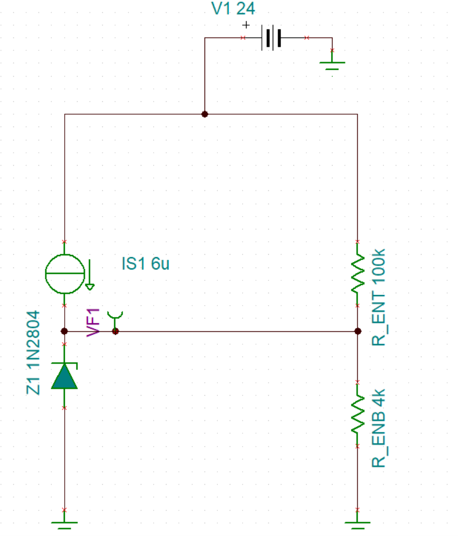

Hi Expert,
I am using LM22675, and I connect EN pin to 24V Vin with a 100kR pull up resistor, and also connect EN pin to GND with a 4.7kR pull down resistor.
Then I test the voltage at EN pin, and get 6.4V test result.
However, the maxim spec of EN voltage refer to datasheet is 6V, can you help me clear about why I get a 6.4V at EN pin? Is the pull up and pull down resistor value incorrect?
Thank you!
