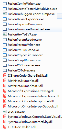

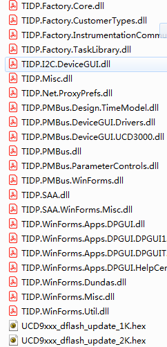

    1.Please disconnect the EVM board from your PC, then launch Fusion GUI it directly from your install folder and let us know if it works. If not, then what is the error message (you said it is not the same)
    2. Please list all the assemblies in your installed folder: usually, it would be in "C:\Program Files\Texas Instruments\Fusion Digital Power Designer\bin". There might be missing assemblies in your folder. Do you have Microsoft .NET framework installed in your PC?

  • Hi, Thomas,
    The assemblies in the "bin" folder look OK.
    * Please make sure that .NET Framework 4.5 is installed and the "data" folder (in the installed folder) is set so that everyone has read/write permission.
    For the purpose of debugging, please disconnect the EVM board when launching the GUI (to eliminate the issue might due to device).
    Anne Ngo

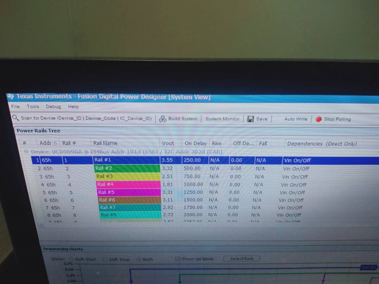

    thank you very much! EVM can connect with PC。because we download the version NET Framework 4.5.2 .the old version is  NET Framework 4
    but now we have a new qustion,we can't programming with it , It cannot be loaded into the file,The display is also different from the official website
    please help to solve it.thanks!

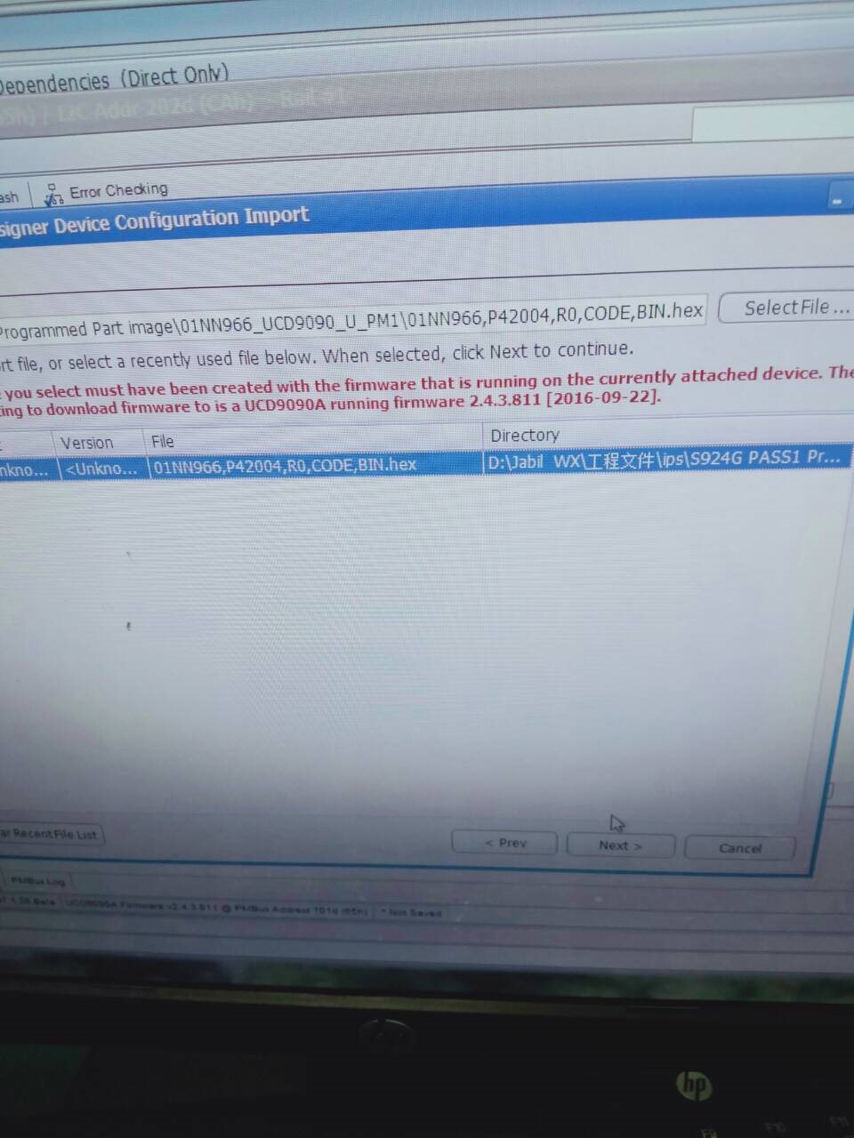

  • Hi  Anne
    I want to load the HEX file to program how to operate. The following is my operation steps. Please help to see what is wrong and why the final image and data are abnormal?thank you
  • Hi
    UCD9090A and UCD9090 are two different products and the hex file are not compatible between them. Please make sure that the hex file matches the device.
    Please refer section 10 migration guide https://www.ti.com/lit/pdf/slva908
