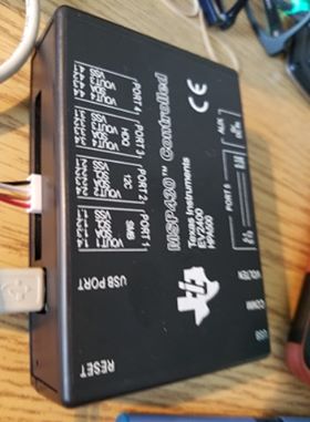

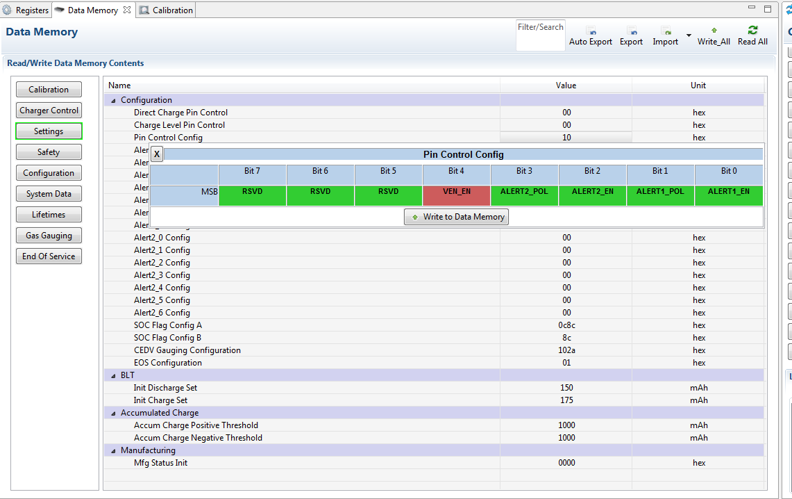

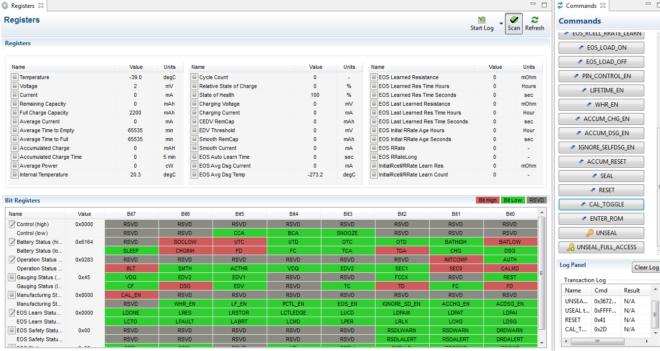

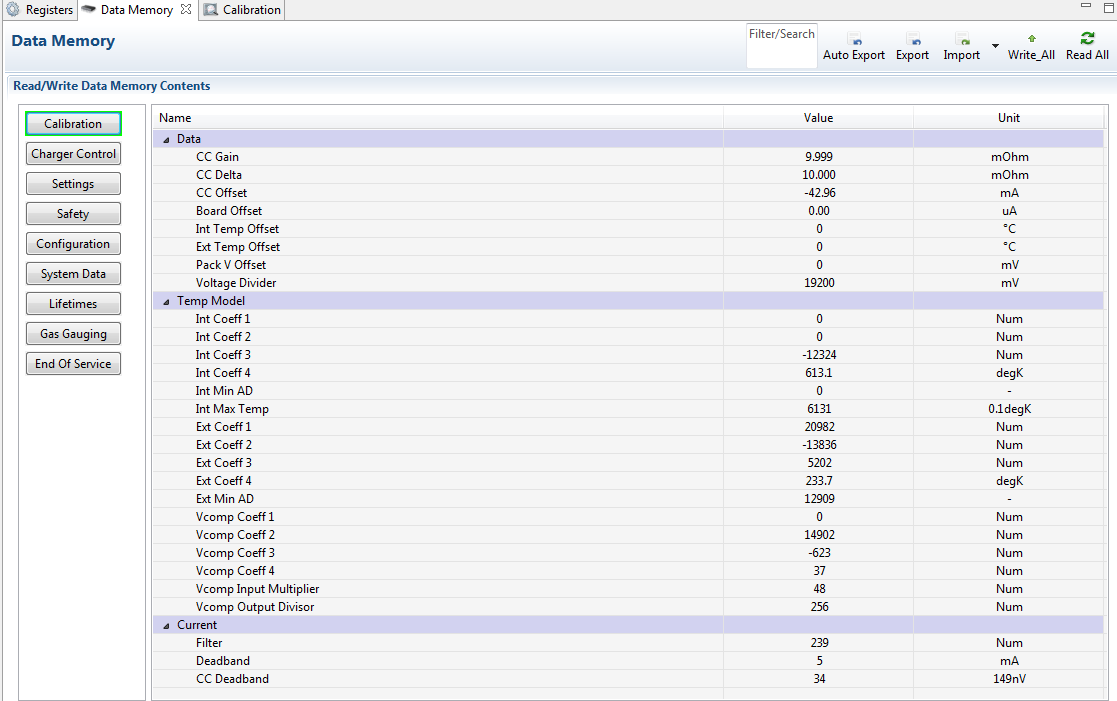

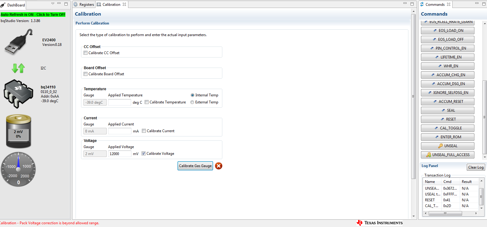

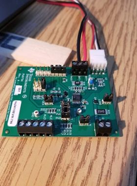

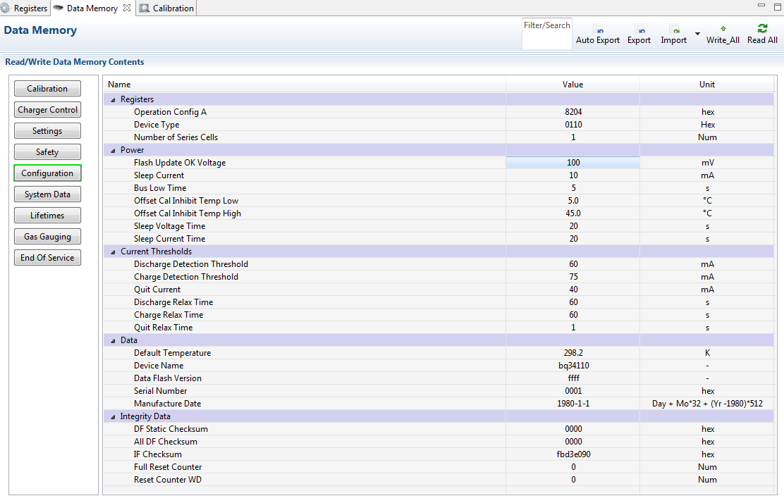

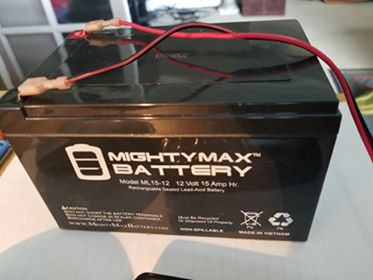

I have a 12V Migthymax battery Model ML15-12 battery and despite your previous answers, I still cannot calibrate my battery voltage with bqStudio. My jumper is in the right place and I followed the setting you mentioned. On the other hand, on my REGIN I have 5.23V and on the REG25 I have 0V. I changed the bq34110 and it works. The error `` Calibration - Pack voltage correction is beyond allowed range`` persists. In addition, in bqStudio when I press read all, all my parameters are modified and return by default. My battery remains gray and indicates 2mV. What can be my problem?
