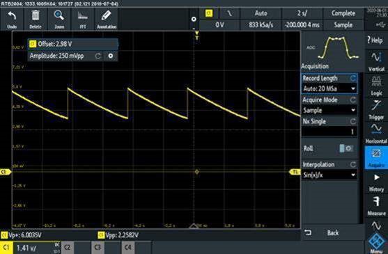

We're seeing something odd when using the TPS61028. We utilize two batteries with our design. One of the batteries goes into VBAT of the TPS61028, which generates an output voltage. We also have a switching circuit that involves using PFETs that allows the overall board to switch from the battery that goes into the TPS61028 to another battery if the battery going into VBAT dies. However, the switching isn't working properly when VBAT goes low because the TPS61028 VOUT seems to be generating an output voltage even though VBAT is low. The datasheet states that the boost regulator will not be able to boost anything if VBAT drops below .9V. We're seeing .2 - .3V on VBAT. Is there a possibility that the regulator is trying to boost even though it is below the minimum requirement? We also have PS tie to ground. Is there also a possibility that power save mode is kicking in when it is dropping below .9V? Any insights as to why we're seeing the boost regulator providing an output under the minimum input requirement is appreciated.
