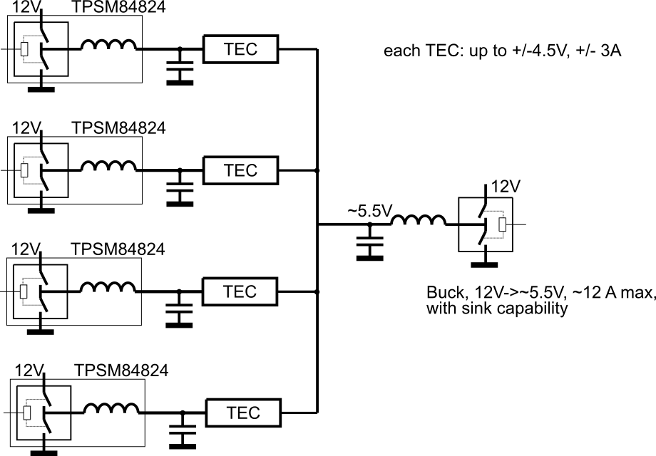

  • Hi to all,
    in my application I have to drive a bunch (4) of Peltier modules. The Peltier modules have cooling and heating ability, depending on the direction of the current that flows through them.
    Each Peltier module requires a maximum of 3A (-3A) at a voltage of 4.5V(.4.5V) when heating(cooling) at maximum power.
    It should be possible to seamlessly control the voltage (or current) of each Peltier module from -4.5V..+4.5V (resp. -3A..+3A).
    Constant current operation would be preferred, but constant voltage operation is also ok, because each Peltier module is part of a separate temperature control loop.
    My idea is to do it in the way that is shown in the picture; would that be possible?
  • Hi Christian,
    If I understand your drawing correctly, the supplies on the left and the one on the right all need sinking capability, right? To get the negative voltage across the TEC, you would set the left TPSM84824 supply lower than the buck at the right, which means the TPSM84824 devices would sink current.
    Based on the sinking current limit for the TPSM84824, I would not recommend using it where it would have to continuously sink current.
    Perhaps a different topology would work better. Here is an app note that gives an example of using a buck-boost converter to drive a TEC.
    The other alternative I may suggest is to use an H-bridge (or 4 switches) to drive each TEC, where you would use the H-bridge to control the polarity of the voltage applied across the TEC. The supply to the top of the H-bridge could be powered by a buck module like TPSM84824 with adjustable output.

  • Hi Christian,
    The reason I would not recommend TPSM84824 is that its negative (sinking) current limit is too close to your required sinking current of 3A. The -3.4A I mentioned is also just a typical value, not min/max. If the sinking current limit is tripped, the FETs will be tristated until HS FET turns on and off again, and HS FET will be turned on again only when output voltage has fallen enough such that the control loop issues a HS turn on, which may not happen if current limit has tripped before the output has been discharged sufficiently.
    We have TPS543B20 which has a much lower negative current limit of -23A and TPS546A24A which has -10A typical negative current limit, but both have output voltage range of 0.6V to 5.5V, meaning that you would need to dynamically adjust the voltage on both sides of the TEC to achieve +/-4.5V across the TEC.
    I referred to the buck-boost example with the TPS63020 just to share the concept, not meaning that it exactly met your voltage and current requirements.While the TPS63020 would not work, perhaps there is a buck-boost controller (external power FETs) that could be used in a similar fashion to meet your requirements. Let me see if the boost controller team has suggestions.
