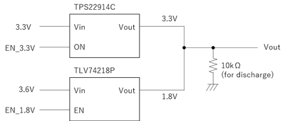

Hi, team
I designed Power MUX using TPS22914C and TLV74218P as below.
In measurement, delay time was 1.8ms when rising 1.8 to 3.3V.
In datasheet of TPS22914C, delay time is 913us (typ).
In the case external voltage applied, is there the factor delay time extend?
Naoki
  • Hi Naoki,
    I see in your scope capture the EN is going low. TPS22914 is an active high device so I think this is EN_1.8V?
    Can you please recapture this issue while probing VIN, VON and VOUT of the TPS22914C?
    For reference, the typ rise time for TPS22914C is 913us and the typ delay time is 622us at 3.3V.
    Finally, for dedicated powerMUX applications is it possible to use TPS2115A in your system instead?

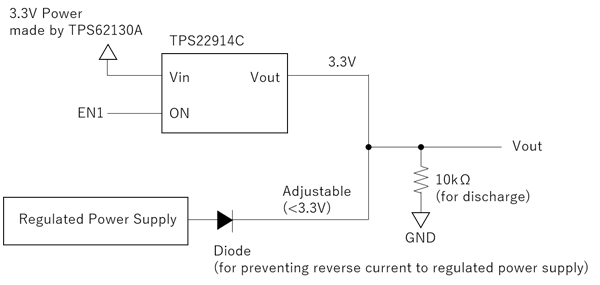

    At previous post, I evaluated using TPS22914C and Regulated Power Supply.
    I don't need exact timing data.
    I want to grasp maximum delay time from 1.8V to 3.3V roughly.
    I would appreciate if you confirm the device behavior.
    Naoki
  • Hi Naoki,
    In this test you are turning on the TPS22914C into a pre-charged rail that is being actively supplied by another source. The device is meant to switch a passive load and not to an active rail. As such it is difficult to provide any confirmation here.
    Can you re-do the test once more with a 10 Ohm resistance in series with the diode (from the diode to Vout) ?
    Thank you for your comment.
    I re-tested below block diagram.
    As a result, the tendency of proportional of external voltage is no change.
    Naoki
  • Hi Naoki,
    Thank you for helping us out with this test. On our end we performed in-house simulations. Thank you for also re-doing the test with small differences as it has helped us expedite this request.
    The extended delay timing is expected behavior of the turn on of the device. With more charge on the Vout, the delay will be extended longer. This is due to the turn on physics of the integrated NFET.
    As I mentioned before, I cannot provide exact timing details but a direct relation that you are seeing is expected. When no charge is placed on the output, the datasheet specification will hold.
    Thank you for choosing TI Power Switches in your designs.
