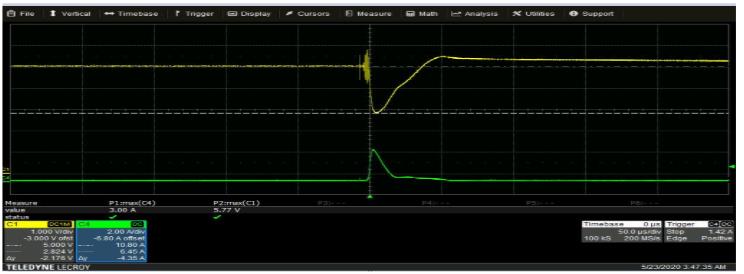

  • Hello O'Mellin,
    The frequency response analysis indicates 8 degrees of phase margin with this loading.
    It is very noisy and almost looks oscillatory.
    I'll need to try the load transient method tomorrow to confirm.
    I'll provide those results when I have them.

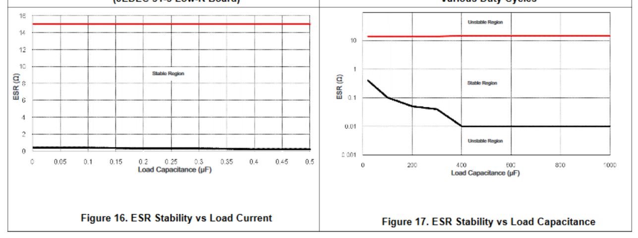

    The datasheet specifies the following for the stability criteria for this device.
    Ceramics can be used but they would need a series resistor to meet the ESR.
    - Stephen

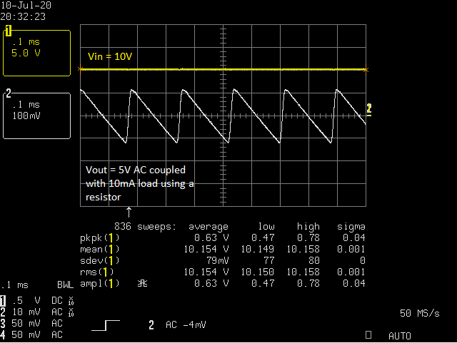

  • Hello O'Mellin,
    I have confirmed that the linear regulator is unstable with this load at all 3 load currents.
    The oscilloscope measurements are provided below showing the AC coupled output and the oscillation seen.
