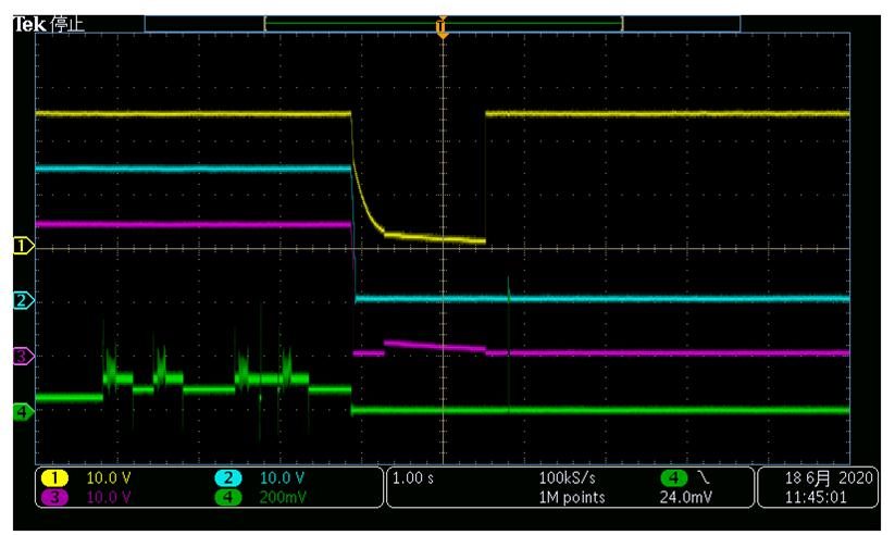

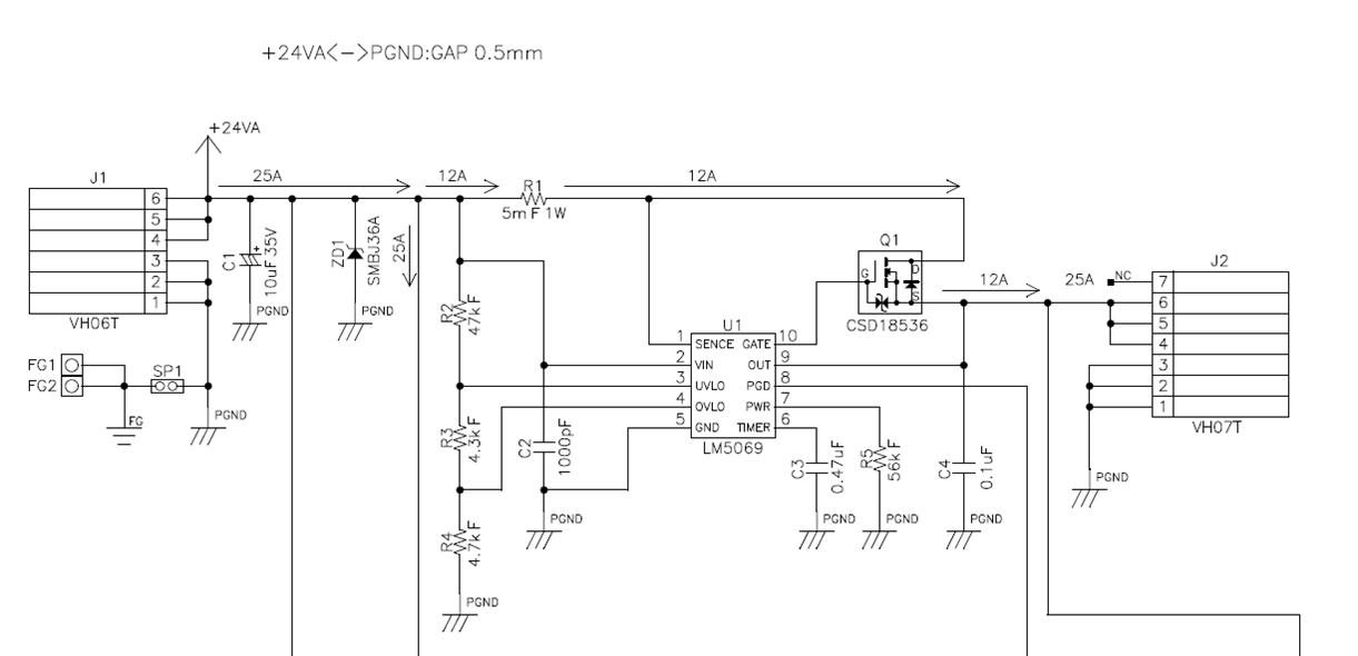

My customer found start-up failure that VOUT is not reached to target voltage.
Could you provide the cause which can be expected?
Vin=24V and current limit is 12A.  The schematic and waveforms are shown in below.
Yellow(Ch1) : VIN(Pin#2)
Blue(Ch2) : OUT(pin#9)
Pink(Ch3) : PGD(Pin#8)
Green(Ch4) : Load Current

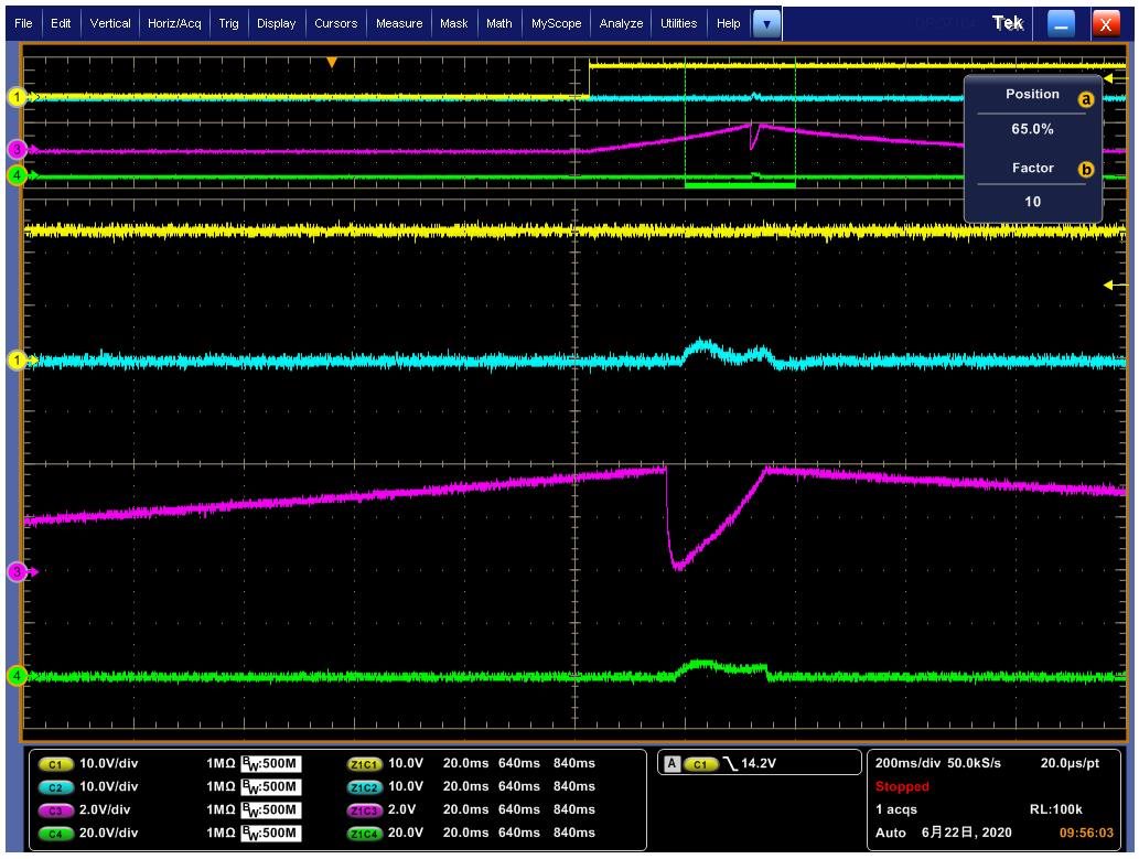

The followings are waveform in failure case and the case to succeed to start up.
Pink(Ch3) : TIMER(Pin#6)
Green(Ch4) : GATE(Pin#10)
<Fail to start up>
<Succeed to start up>
