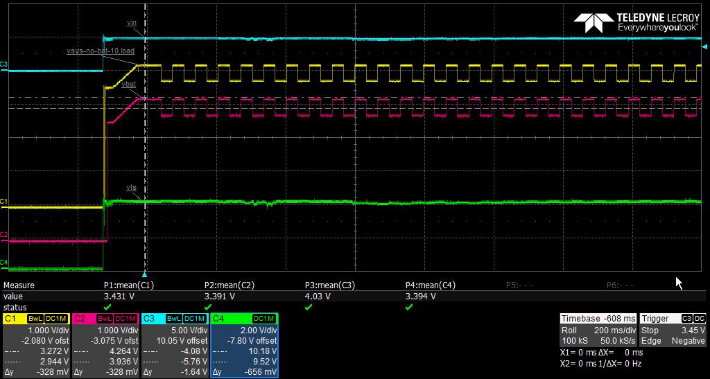

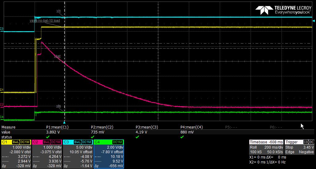

  • Hi Ricardo,
    I need 2 condition for operation, Have bettery and no battery.
    I have attached 4 waveforms. (it's only the Vin power on status)
    1: Vin=5V, No Battery, Vsys have 10ohm, load, Vts=4V
    2: Vin=5V, No Battery, Vsys have 10ohm, load, Vts=1V
    3:Vin=5V, Have Battery, Vsys have 10ohm, load, Vts=1V
    4:Vin=5V, Have Battery, Vsys have 10ohm, load, Vts=4V

  • Hi Ricardo,
    Yes, I have set Ts=4V(85%), and I don't remove the battery.
    You can see my 1st test waveform of power-up.
  • Gordon,
    At VTS 85% TS is disabled or otherwise known as the TS open condition. It is expected behavior for battery detection to occur in the TS open condition. There is nothing you can do to prevent this without external circuitry.
    You could try to clamp the TS pin so the open condition does not occur, but you would never be able to perform battery detection regardless of JEITA state. Unless this is what you want? I am also assuming your thermistor is attached to the battery pack.
    Ricardo

  • Hi Gordon,
    To reiterate, the charger is in TCOLD for VCOLD=60%*REGN <= V(TS) < VTS_DIS=70%*VREGN.  Because you are forcing V(TS)=4V>70%REGN, TS function is disabled and will not prevent battery detection.  I agree that the BQ24250 datasheet could be more descriptive.  You can also disable battery detection by disabling charge.  Or you can change to the pin to pin compatible BQ24250C which does not have TS pin disable function.
