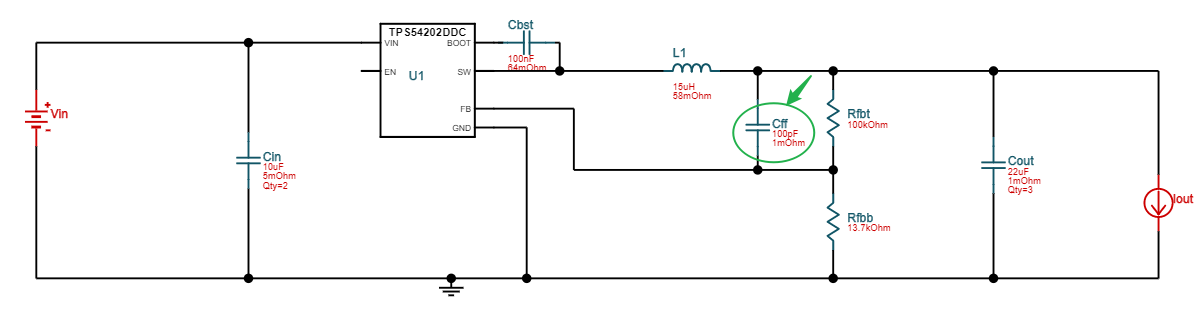

TPS54202: Feed-Forward Capacitor

my customer want to use TPS54202 for two design, one for 12V input 5V1.5A, another FOR15V input 3.3V150mA. but according to datasheet, the feed-forward capacitor is differnt: one is 56pf, another is 75pf.  they'd like to use a same 100pf for these two designes and want to know if any problems. please kindly offer your comments. thanks.
