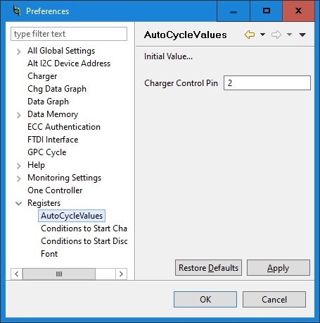

In spite of the non existent TI documentation on using AutoCycle with the BQ40Z50_Rx devices, I have managed to get version 1.3.100 bqStudio's AutoCycle working with the BQ4Z50-R3. There is one thing I haven't been able to work out what it does and that is the AutoCycle Values option, see picture. Can anybody enlighten me as to what this option does? What pin does it refer to and what are the options?

  • Hello Ian,
    It seems that your image was not uploaded properly as it doesn't show up.
    However, the auto-cycle feature is an unfinished planned feature that has yet to be fully implemented properly. I do not recommend you use it. You should go through the learning cycle manually.

  • Here is the picture again. I still would appreciate the answer to my question.
