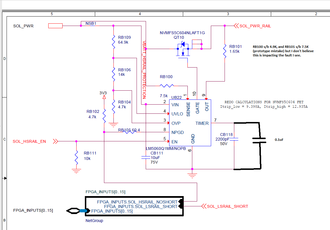

I am using an LM5060 gate driver to switch a common high side rail for 6 TPS1H100 high side drivers (the LM5060 is an emergency high side rail shutoff). The "LM5060-sch" file shows the relevant section of the schematic. An FPGA controls the EN input on the LM5060, and monitors the nPGD output. The FPGA has a state machine to control the LM5060; when the microcontroller want to turn on the rail, the FPGA starts a 3ms timer and asserts the EN input. If the timer expires before nPGD is asserted (goes low), a fault is flagged. Once nPGD goes low, the state machine transitions to the "ON" state and if nPGD negates during the state (goes high), a fault is flagged and EN is negated until the microcontroller shuts the rail off and tries to power up again.

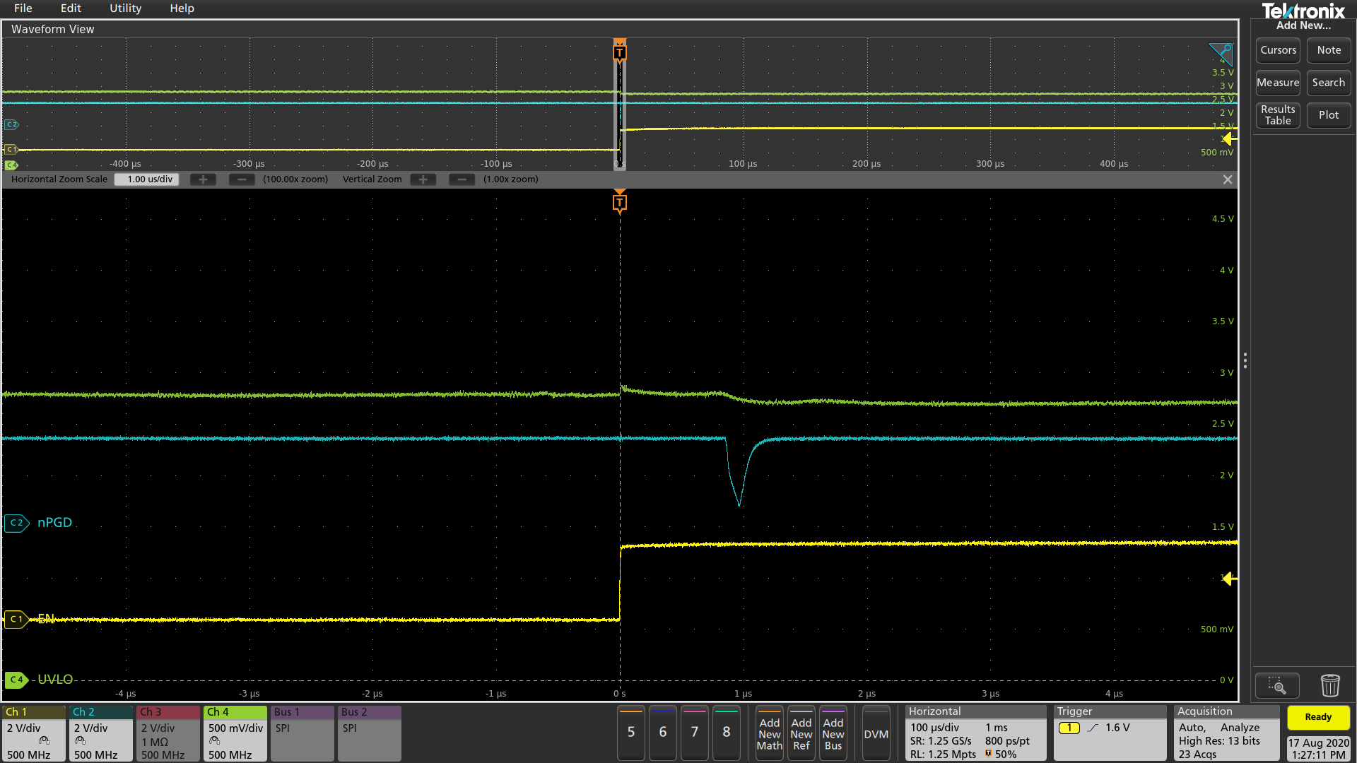

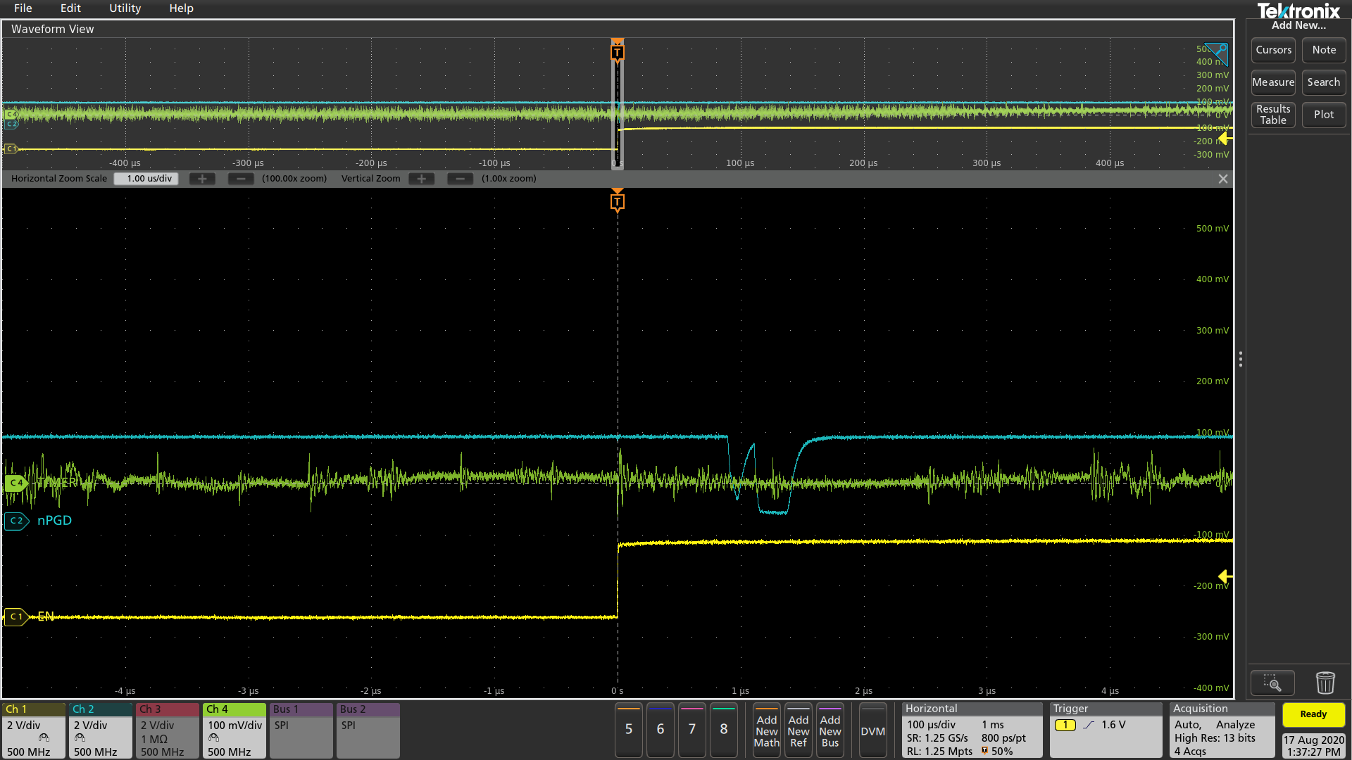

There is a brief glitch filter (~625ns) on the FPGA input from the nPGD pin to prevent external noise from tripping a fault. When I turn on the LM5060, there is a glitch on the nPGD output, which in certain cases exceeds the duration of my glitch filter, causing the FPGA to detect a fault (and turn off the LM5060). The attached "LM5060-GOOD" screen shot shows a successful startup, where the glitch is small (and is suppressed by the glitch filter). The "LM5060-BAD" screen shot shows a failure, where the glitch is of an extended duration, causing the FPGA to trap a fault and negate the EN command.

#1: Schematic diagram of relevant circuit
#2: "Bad" turnon; nPGD has an extended glitch, and FPGA negates the EN signal, latching a fault.
#3:  "Good" turn on; There is still a brief, unexplained glitch, but it is suppressed by the FPGA glitch filter.

  • 1.  Tying the pullup to SOL_PWR would annihilate the FPGA input pin, so I'm afraid that I can't do that.
    2. I did a manual audit of the routing and found four signal nets that run adjacent to the trace for more than 0.250".  I then ran each net to the oscilloscope to check if there was any activity on them.  Three of them aren't switching at any time during the capture; the fourth is the EN line, which is already included in the oscilloscope traces, and is not switching when the glitch is observed.
    The fifth trace, which has a coupling length of 0.050" and an air gap of 0.012" (digital signal traces are all 7 mil wide) during the coupling event, is the oscillator 8Mhz external clock which IS switching during the glitch, and is imposing approximately 15mV of crosstalk onto the nPGD signal, which is negligible compared to the available 450mV noise margin when nPGD=0, and the 1.3V noise margin when nPGD=1.

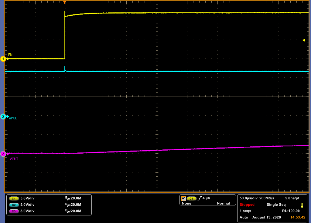

    Thanks for checking on the mentioned things. I have not observed similar issue at my end on EVM, Please see below test waveforms.
    Can you check LM5060 alone to ruleout of dependency of other circuits on your board and to confirm the LM5060 behavior

    3.  I re-probed all of the LM5060 pins and could not find any smoking gun, however, on the SENSE line, I did notice some timing information which may or may not be helpful (as seen above).  The glitches seem to occur before the LM5060 internal current sink is turned on at the sense pin, as it happens before the sense pin voltage starts falling.

    You can see in the screenshot below that this minimal build still exhibits this glitch on the EN line.  Please forward your contact information to me at "glenn.doiron" AT "jakebrake.com" and I will send the PCB for your analysis, as well as additional information that I don't want posted here (Gerbers, full schematics) but may help you in finding out why this is happening.
