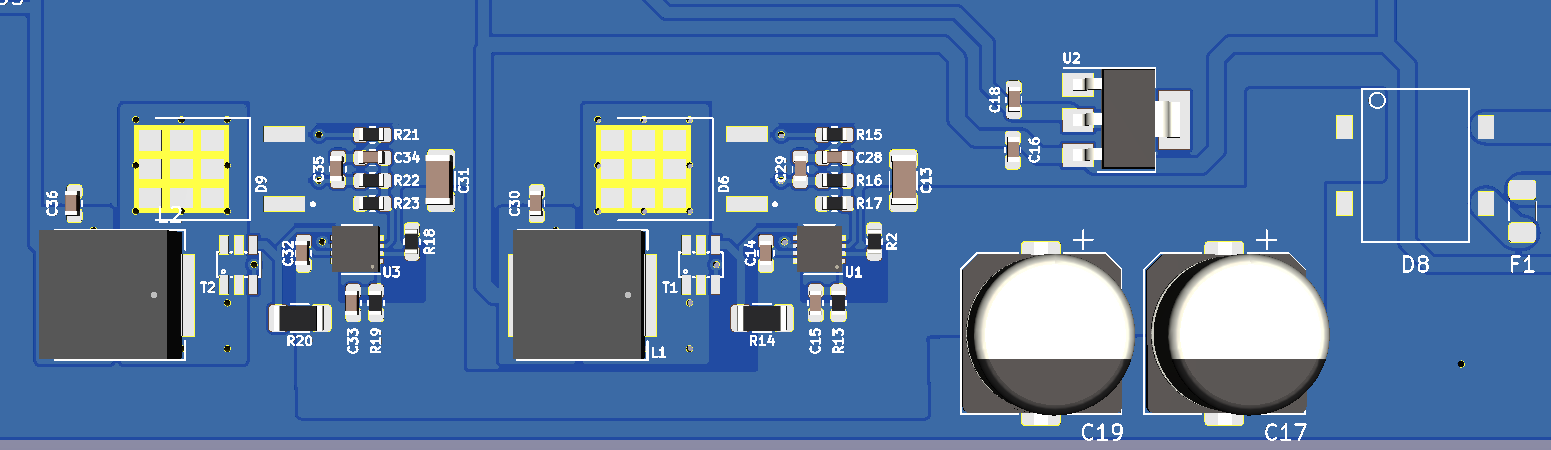

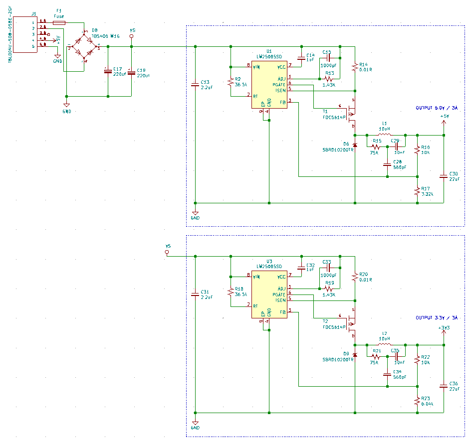

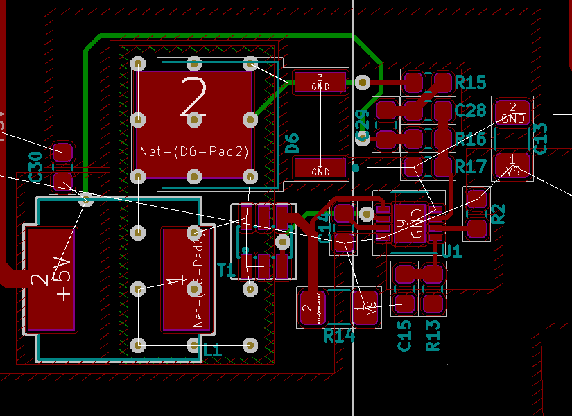

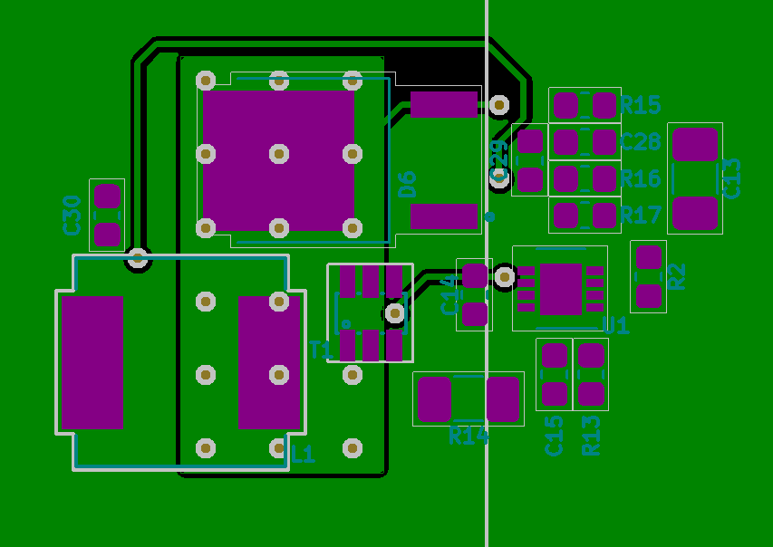

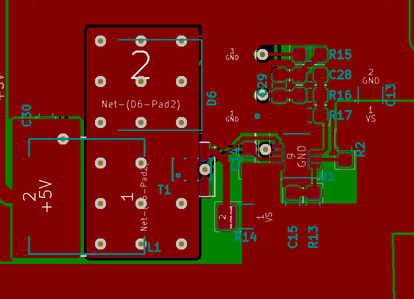

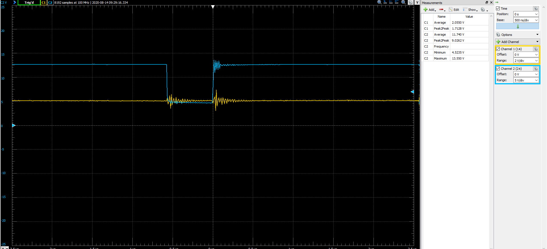

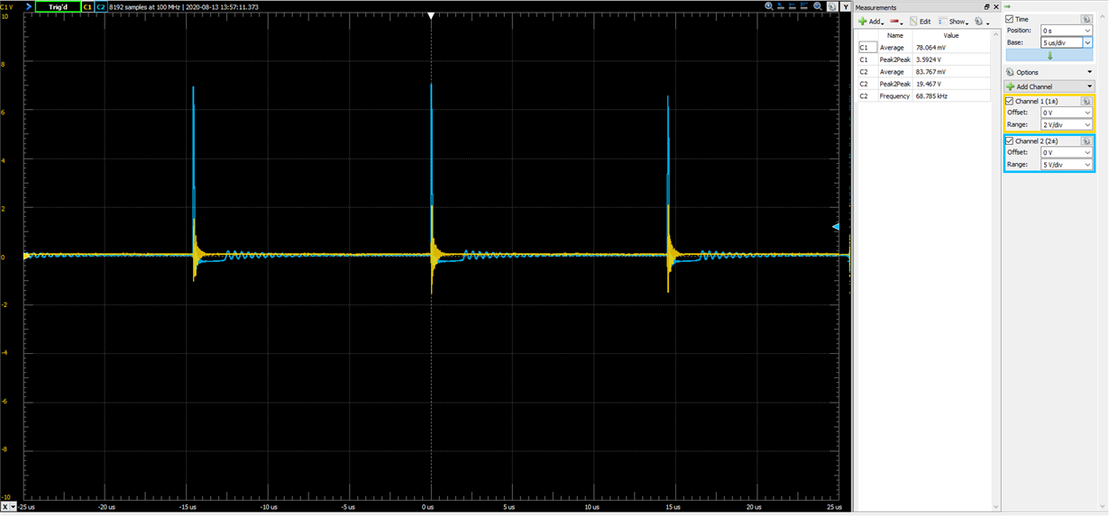

I used WEBENCH® Power Designer to design the DC part of a  24 VAC to 5V 3A and 3.3V 3A supply using the LM25085SD/NOPB.  The 5V and 3.3V circuits are identical except for the R17 and R23 which are used to set the output voltage.

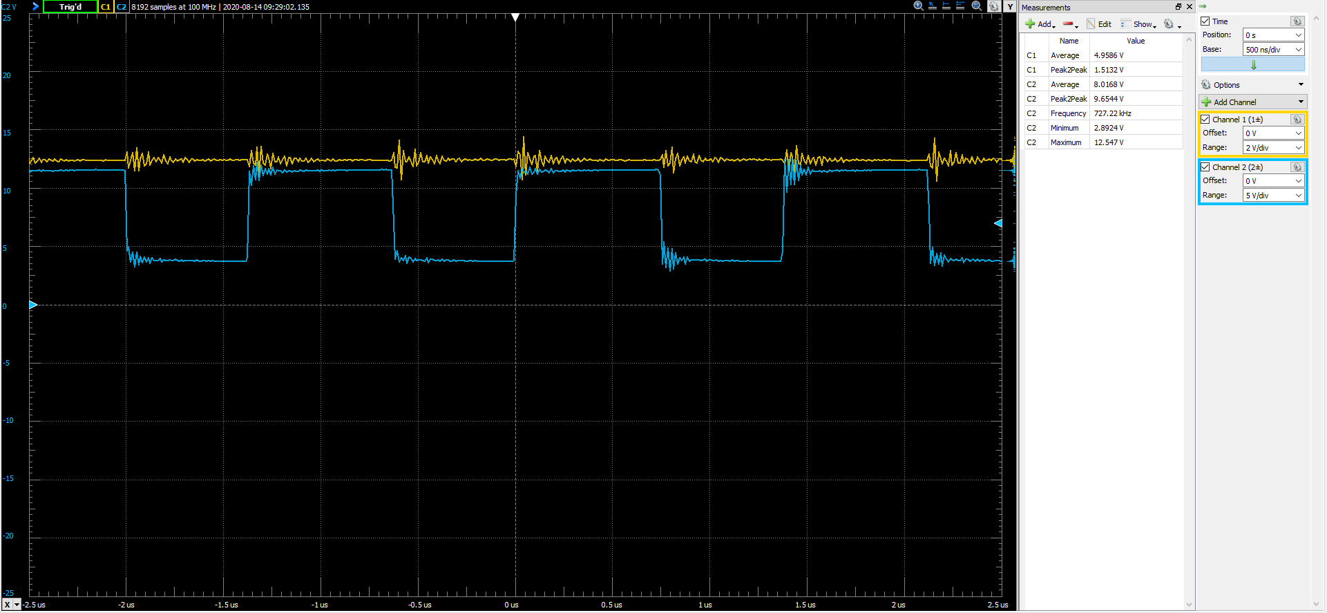

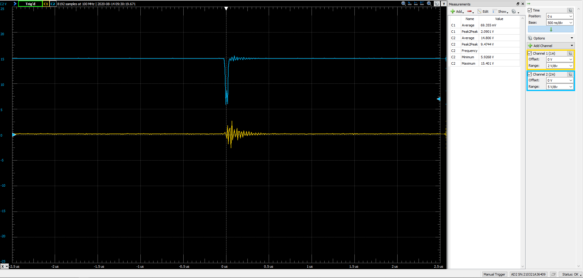

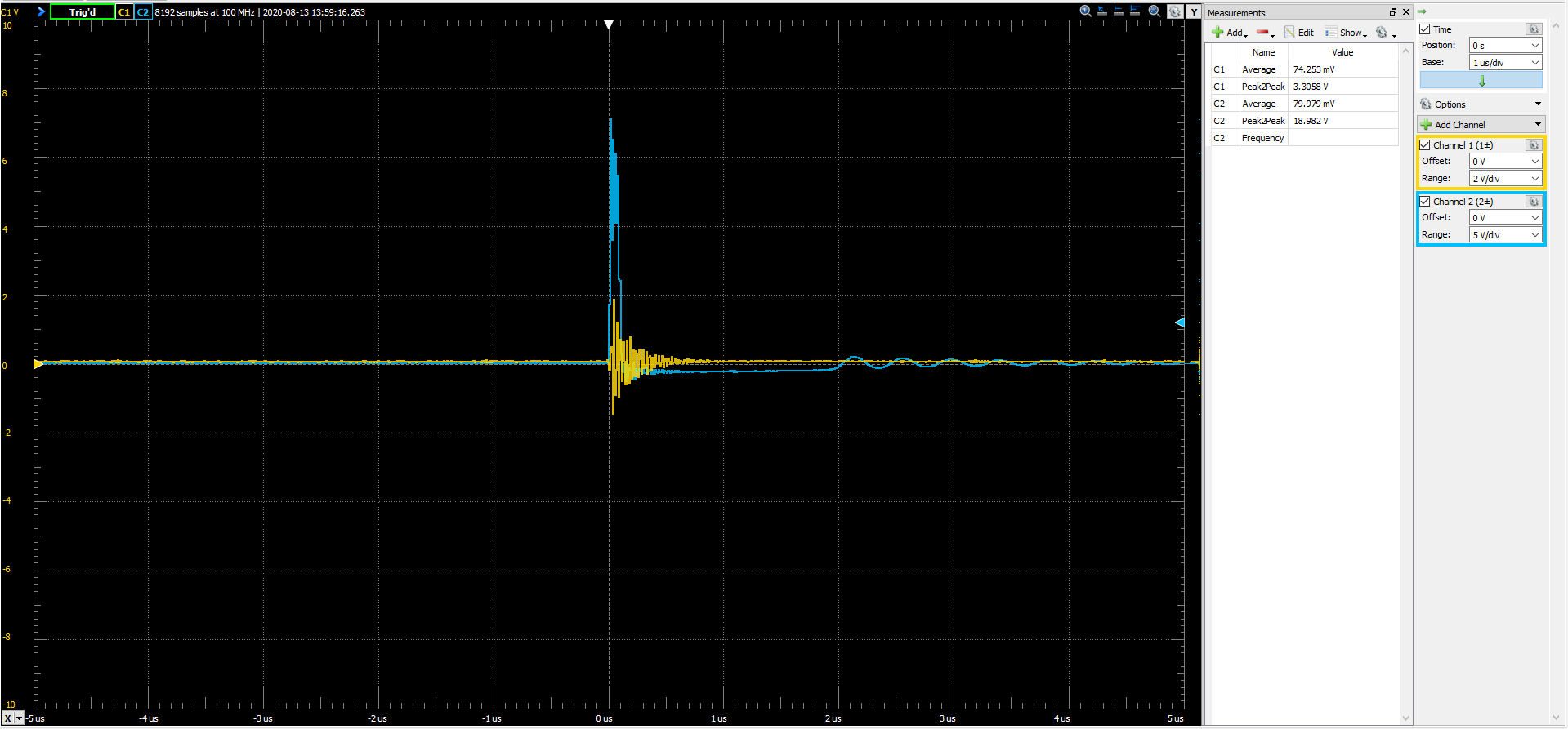

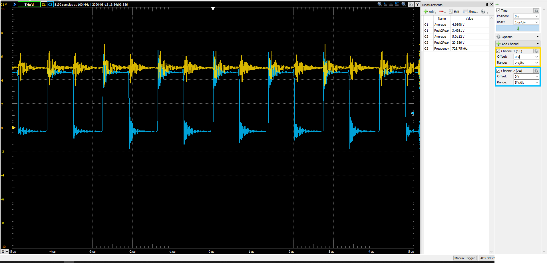

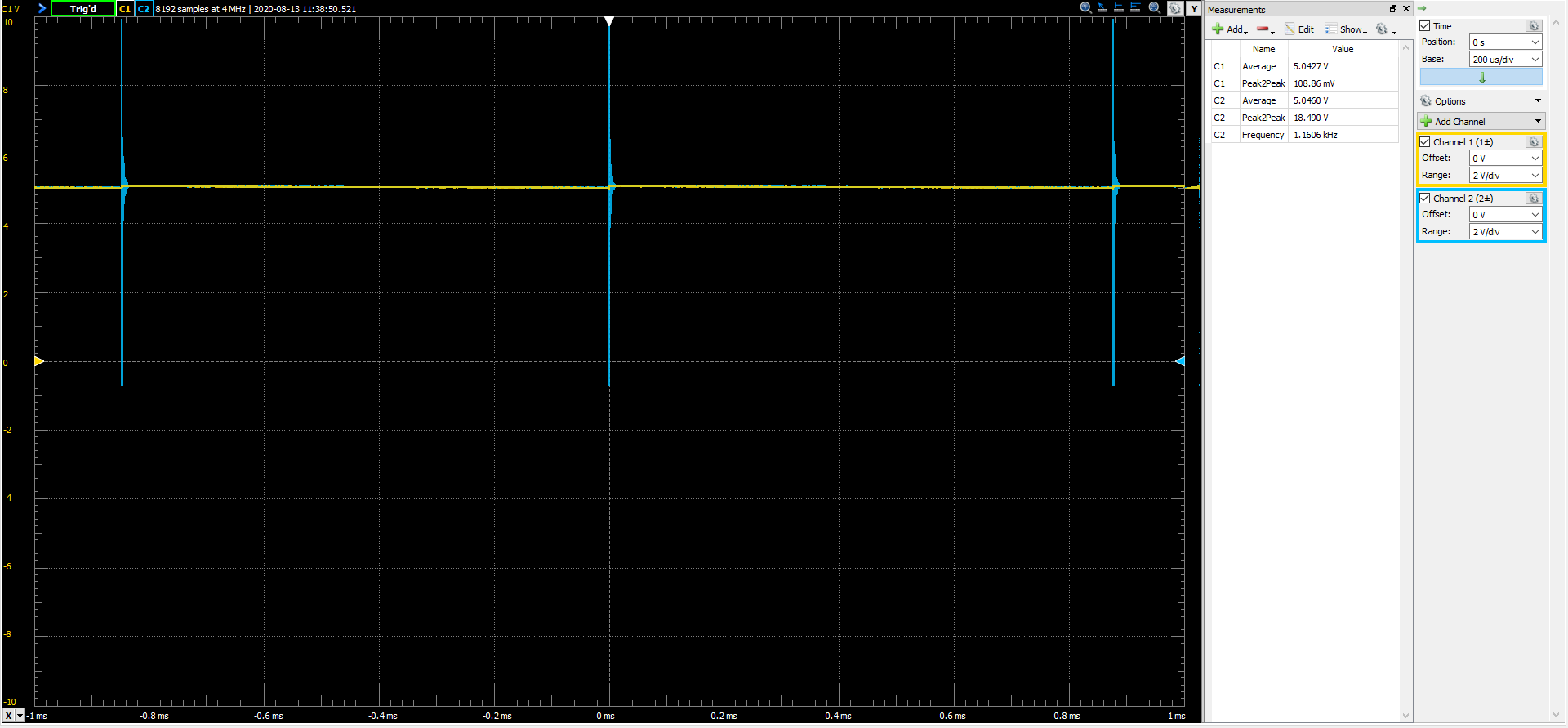

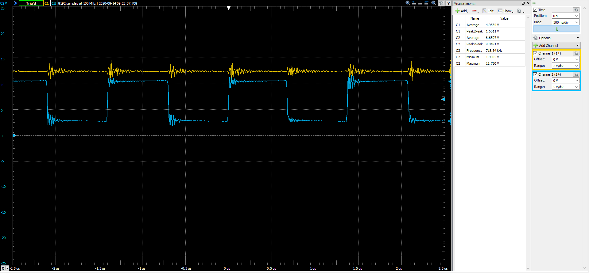

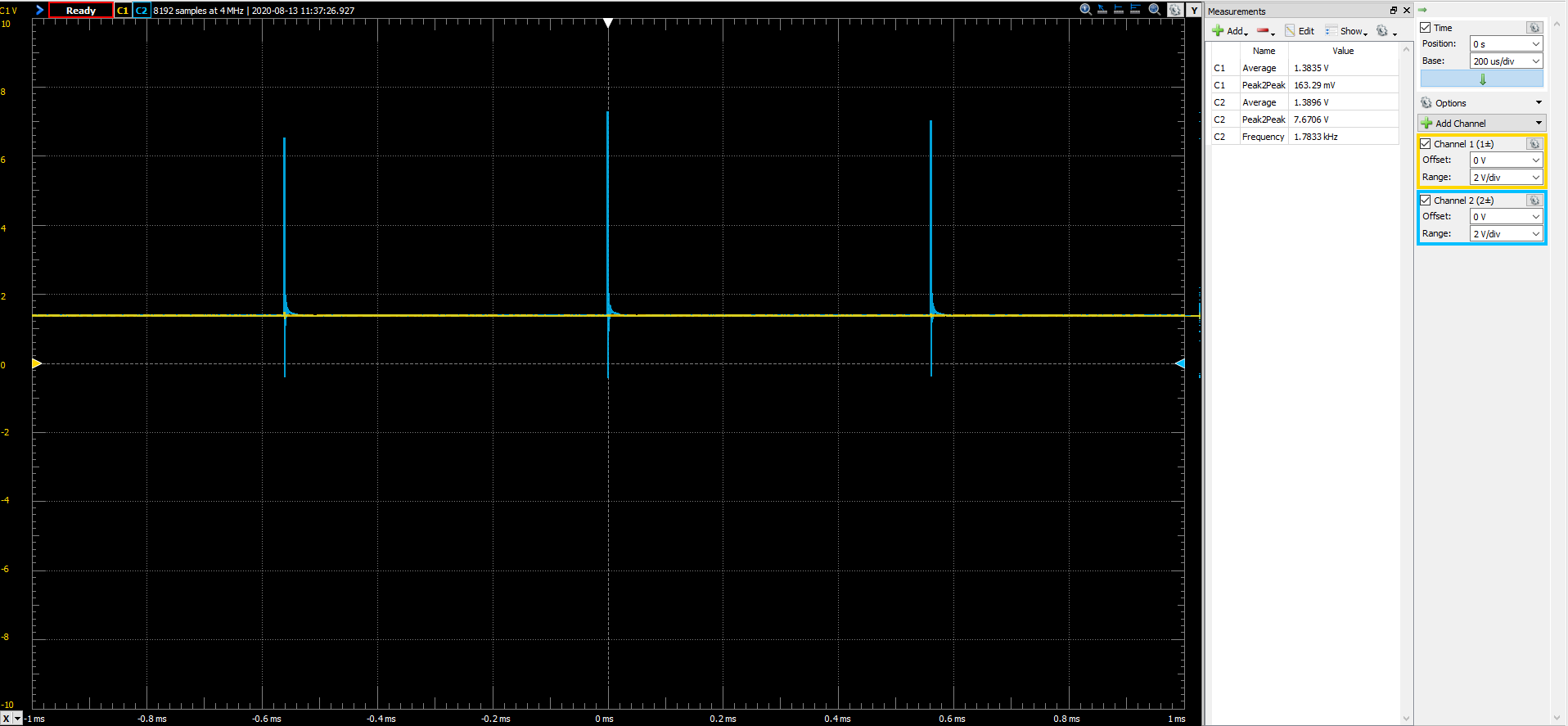

When the circuit is powered via 24VAC transformer VS is typically around 34VDC and both the 5V and 3.3V hover around 2V.
Lowering the input voltage such that VS is ~12VDC results in the expected 5V and 3V output.  If I slowly increase the input voltage, eventually the rails will drop to again.  I've primarily been experimenting with the 5V rail and the drop out point seems to be around VS=19VDC, but also seems to vary with the output load.
I'd appreciate any suggestions / troubleshooting steps.  Please let me know what other info I can provide to help.
