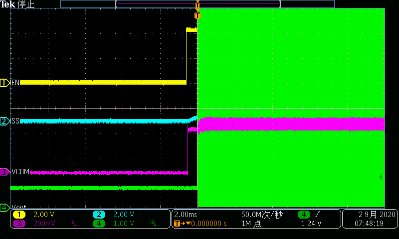

  • Dear Anthony
    During the pre-bias test, I enabled EN and found that the Vcomp voltage was pulled high, but there was no immediate output. I want to verify whether it is because the SS/TRK pin is lower than the FB voltage, which causes the subsequent clock circuit to be disabled.
  • Hi Yadong,
    The COMP pin has a minimum clamp voltage that it will pulled up to as soon as the device is enabled. As can be seen in the waveform you measured, this is around 360 mV. In this case it is not the difference between the FB voltage and the SS/TRK voltage pulling up COMP, it is this other circuit.
    There is also start switching threshold at the COMP pin which is slightly above this minimum clamp voltage, in the range of 10s of mV. When SS/TRK is greater than FB, the error amplifier pulls up the COMP pin and the TPS54824 starts switching. The clamp voltage is kept close to the switching voltage so that the device can go in and out of skip mode quickly. Even though this is a FCCM converter, it will still skip typically during startup or a large load step down.
