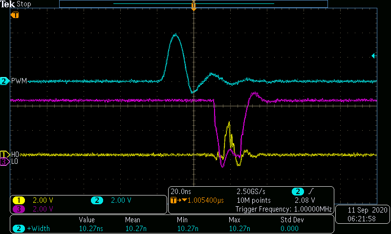

  • John, so far I have not been able to reproduce the previous issue described showing any glitches using the LMG1210EVM.
    The setup is with the LMG1210 running in PWM mode with as little as 10ns pulses showing no signs of glitches on HO and LO.
    Waveform below shows the HO and LO with respect to GND. I will try to get to 1.8ns pulse width to verify the datasheet specification.
    -Mamadou

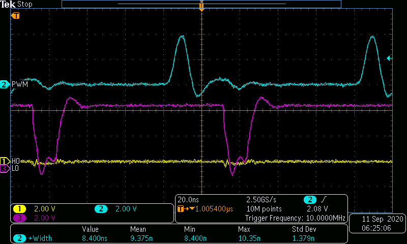

    Attached is waveform on the same EVM with 8ns pulse width in which case HO false low when the pulse width is trending toward 0.
    I have not observed any destructive behavior in such conditions using the aforementioned LMG1210EVM in PWM mode with the GaN FETs populated.
    -Mamadou
